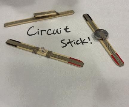

We present the Circuit Stick—a fun, hands-on way to introduce young learners to the basics of electricity and circuits! This project simplifies the traditional approach to circuit building by embedding components directly into craft sticks, making it easier and more engaging for kids to explore the magic of circuits.
With color-coded sticks and simple assembly using copper tape, children can quickly grasp the principles of how electricity flows, lighting up their creativity along the way. Perfect for classrooms, STEM workshops, or at-home activities, Stick Circuits are designed to make learning about electricity accessible, safe, and, most importantly, fun!
