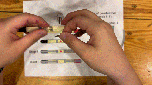

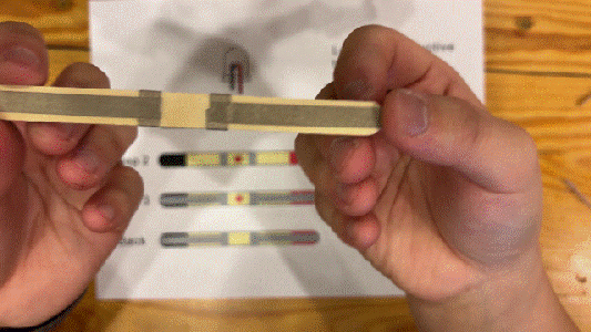

Step 2: Attach the LED
Bend the legs of the LED outward to the sides.

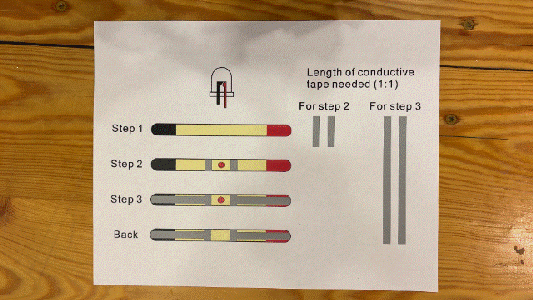

Then use the conductive tape to individually attach each leg of the LED to the stick. Refer to printed instructions for the precise length and placement of the tape.
Ensure the LED's positive leg aligns with the red-marked side of the stick and the negative leg aligns with the black-marked side.

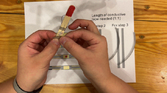

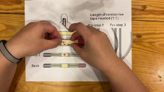

Step 3: Tape the Stick
Apply conductive tape along both sides of the stick.
Ensure each leg of the LED is connected to one side of the tape from the previous step, forming a complete circuit path.

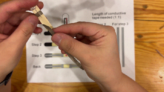

Step 4: Check for Short Circuits
Inspect the stick to make sure:
- Each LED leg connects only to its respective side of the stick.
- The conductive tapes on both sides of the stick do not overlap or touch.
Optionally, use a power supply to test the LED Stick to confirm it is working.
