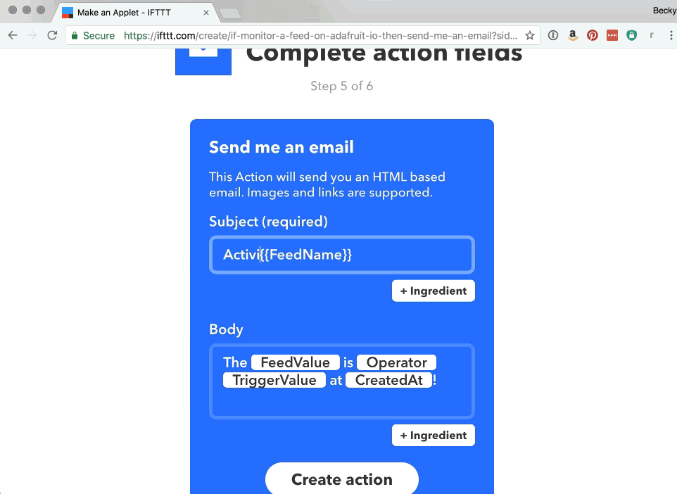

Step 5: Connect IO Feed to IFTTT

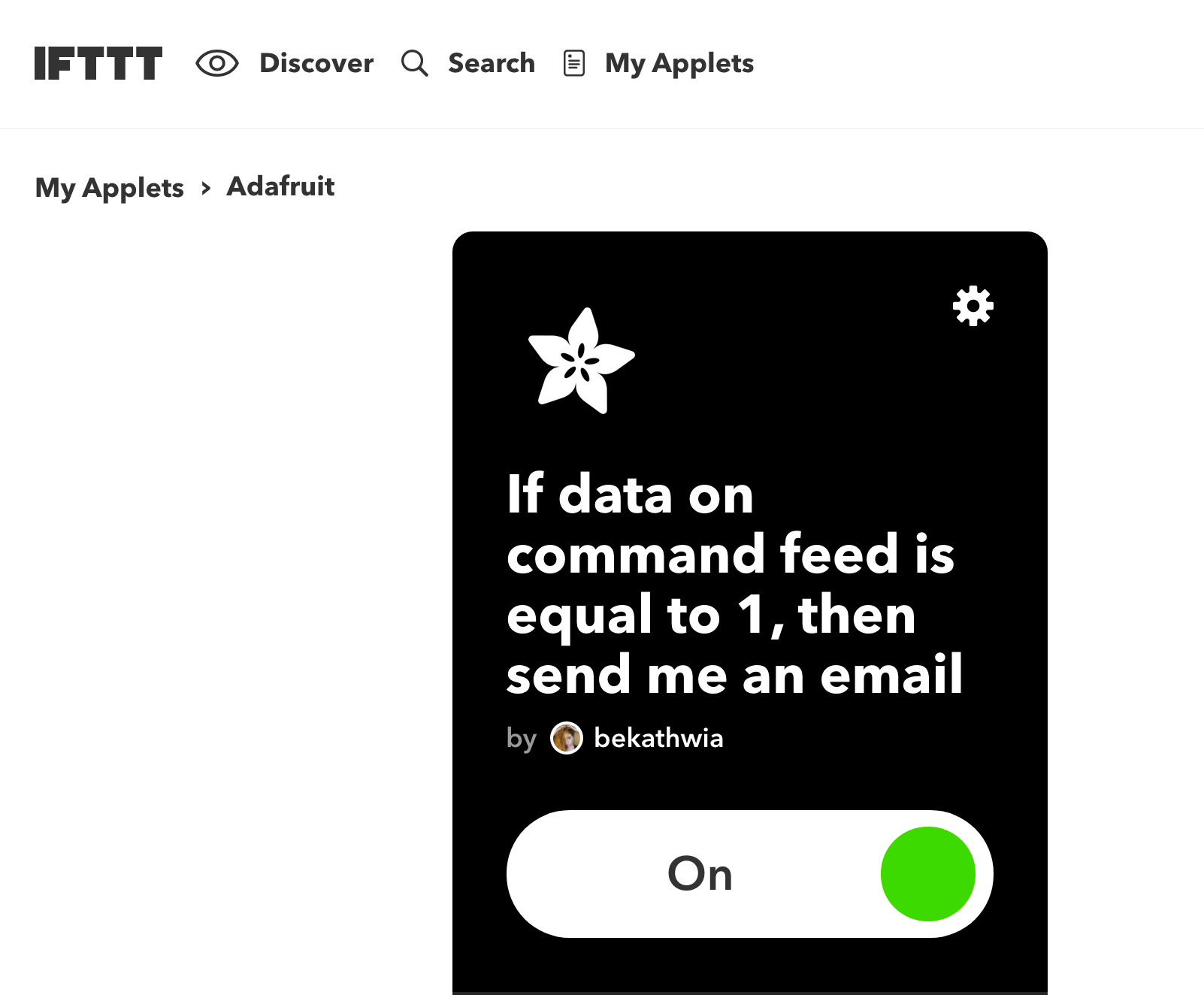

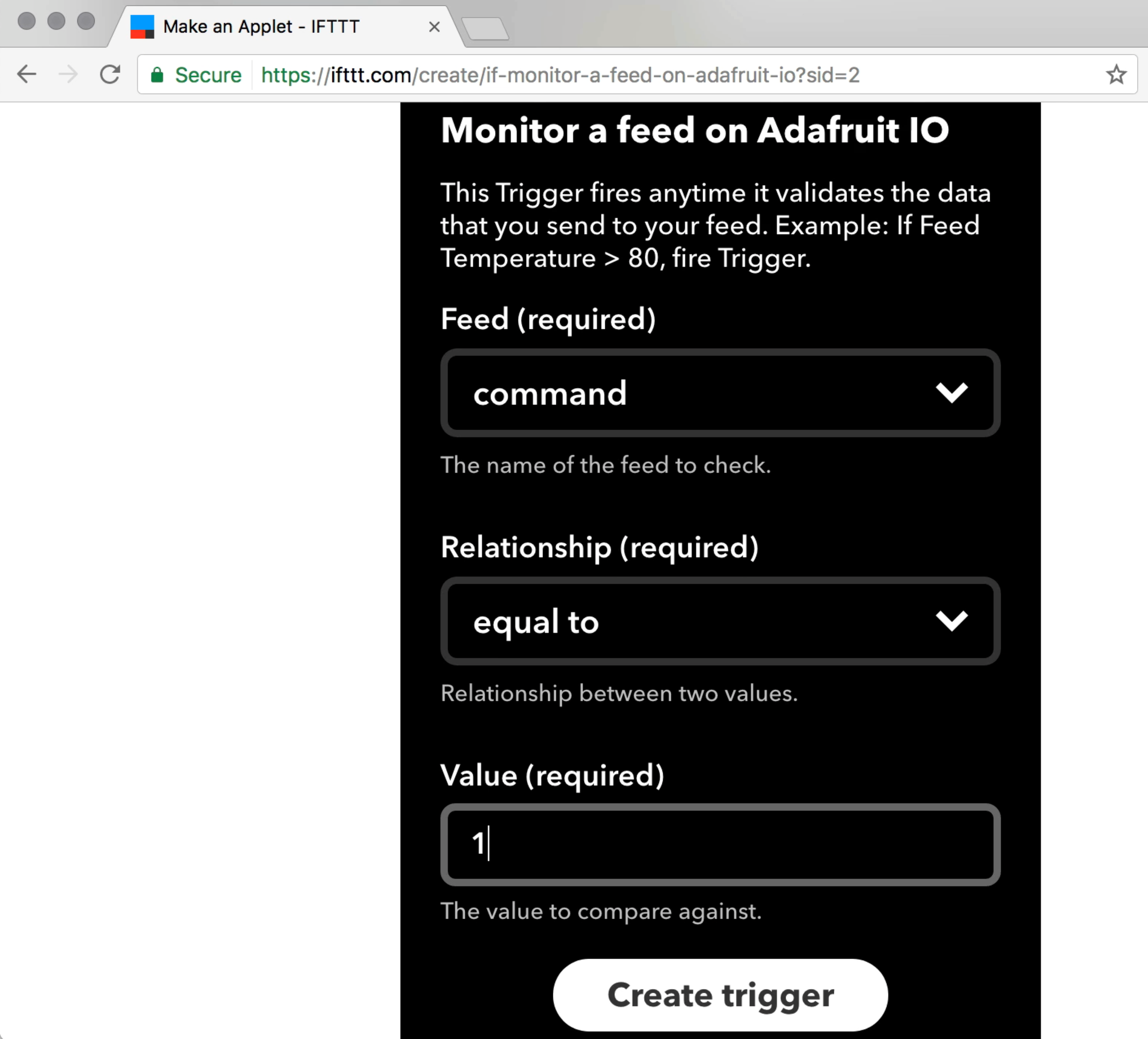

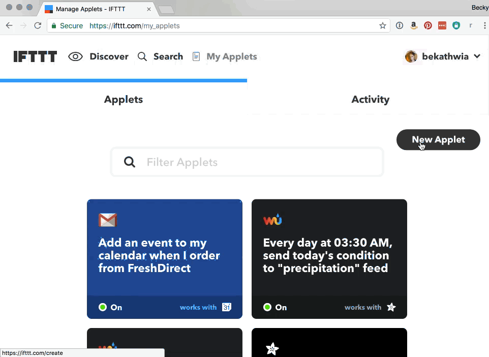

Sign in to your IFTTT account and click My Applets at the top of the page, then the button marked "New Applet" on the right of page. Click "+this" to choose an input service, and start typing "Adafruit" into the search bar until it appears, then click the button marked Adafruit to see the available triggers. For this example, either trigger will work, but for the sake of showing more settings, choose "Monitor a feed on Adafruit IO."
From the dropdown menus, select the feed name "command" and the relationship "equal to". Type the number 1 into the Value field, then click the button marked "Create trigger".
Next, click "+that" to choose an output service, and then click "email" (or choose a different output service like Twitter, SMS, etc.). Click through to customize the email message, then click the button marked "Create action". Lastly, customize the name of the applet (if you wish) and click the button marked "Finish".

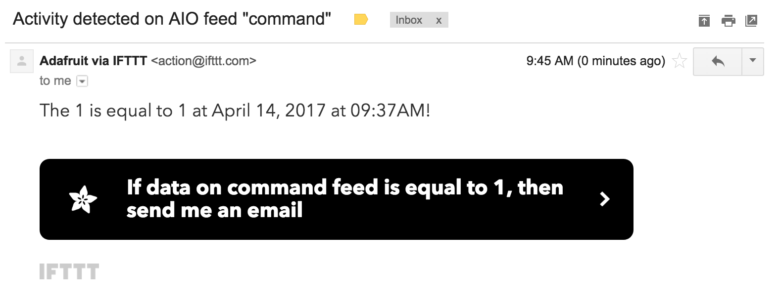

Now when you press the button, you should see an email in your inbox (up to a few minutes later).

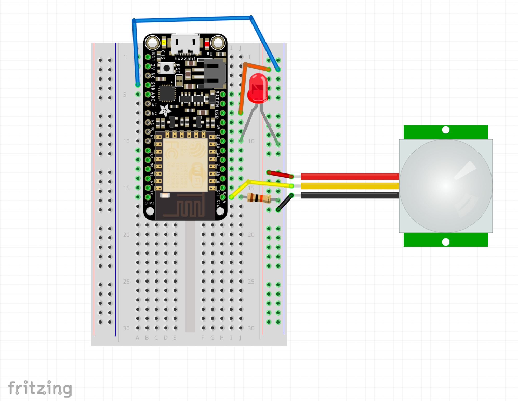

One particularly fun upgrade to this circuit is to add a PIR motion sensor. PIR stands for Passive Infrared, which describes how the sensor works— by detecting changes in the overall amount of IR light it can "see" with its collector dome. This sensor is designed to output a simple HIGH/LOW signal when its (adjustable) threshold is exceeded, so we can easily use it in place of a pushbutton using the same circuit we've been using all along. In addition to the PIR motion sensor, grab a one more wire (for powering the sensor), a 10K ohm resistor (brown, black, orange, gold) and wire them up according to the following circuit diagram:
The PIR motion sensor comes with a wired three-pin connector that plugs into three header pins on the sensor board— the black wire should line up with the pin marked GND.
The code to test the motion sensor is very similar to the button test code, with some minor (but significant) changes. Since the motion sensor sends a HIGH signal when it detects movement, we'll need to remove the internal pull-up resistor from the pinMode declaration in the code's setup, and change the main if statement to check for a HIGH signal instead of a LOW.
