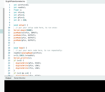

Step 6: Write the Program
Download the file below, or go to https://github.com/tejbho/ArduinoProjects/blob/main/3LightPotentiometer/3LightPotentiometer.ino
Step 7: Test the Circuit
Turn the knob on the potentiometer. The Serial Monitor should write the value of the potentiometer continuously. The red LED should turn on when the value is less than 3. The yellow LED will turn on if the value is between 3 and 4. The green LED will turn on if the value is greater than 4. Download the video below to see how it works.
