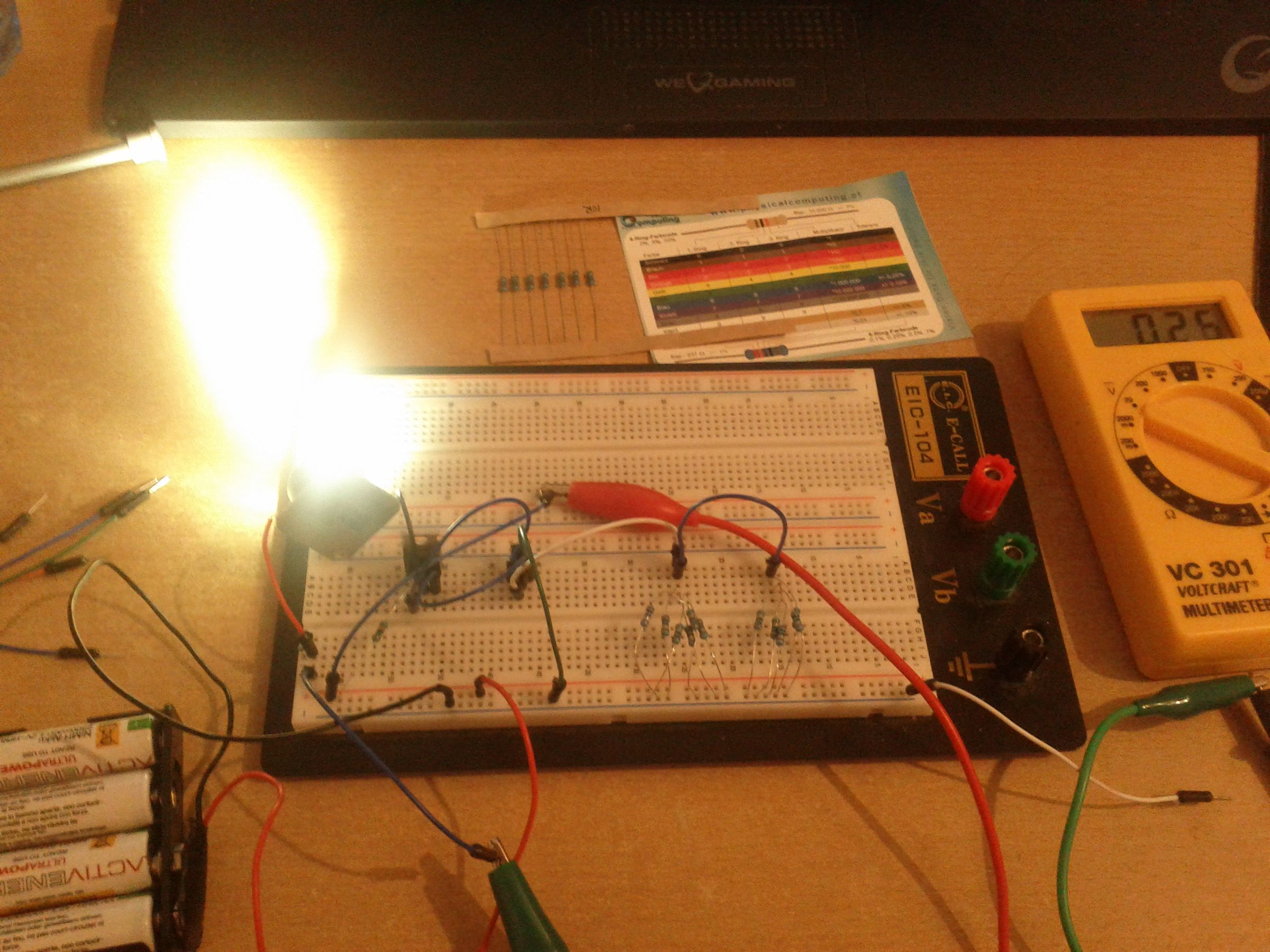

Step 6: The New Stuff!! Constant Current Source #1
lets get to the new stuff!
The first set of circuits are all small variations on a super-simple constant-current source.
Pros:
- consistent LED performance with any power supply and LED's
- costs about $1
- only 4 simple parts to connect
- efficiency can be over 90% (with proper LED and power supply selection)
- can handle LOTS of power, 20 Amps or more no problem.
- low "dropout" - the input voltage can be as little as 0.6 volts higher than the output voltage.
- super-wide operation range: between 3V and 60V input
Cons:
- must change a resistor to change LED brightness
- if poorly configured it may waste as much power as the resistor method
- you have to build it yourself (oh wait, that should be a 'pro').
- current limit changes a bit with ambient temperature (may also be a 'pro').
So to sum it up: this circuit works just as well as the step-down switching regulator, the only difference is that it doesn't guarantee 90% efficiency. on the plus side, it only costs $1.
Simplest version first:
"Low Cost Constant Current Source #1"
This circuit is featured in my simple power-led light project.
How does it work?
- Q2 (a power NFET) is used as a variable resistor. Q2 starts out turned on by R1.
- Q1 (a small NPN) is used as an over-current sensing switch, and R3 is the "sense resistor" or "set resistor" that triggers Q1 when too much current is flowing.
- The main current flow is through the LED's, through Q2, and through R3. When too much current flows through R3, Q1 will start to turn on, which starts turning off Q2. Turning off Q2 reduces the current through the LED's and R3. So we've created a "feedback loop", which continuously monitors the LED current and keeps it exactly at the set point at all times. transistors are clever, huh!
- R1 has high resistance, so that when Q1 starts turning on, it easily overpowers R1.
- The result is that Q2 acts like a resistor, and its resistance is always perfectly set to keep the LED current correct. Any excess power is burned in Q2. Thus for maximum efficiency, we want to configure our LED string so that it is close to the power supply voltage. It will work fine if we don't do this, we'll just waste power. this is really the only downside of this circuit compared to a step-down switching regulator!
setting the current!
the value of R3 determines the set current.
Calculations:
- LED current is approximately equal to: 0.5 / R3
- R3 power: the power dissipated by the resistor is approximately: 0.25 / R3. choose a resistor value at least 2x the power calculated so the resistor does not get burning hot.

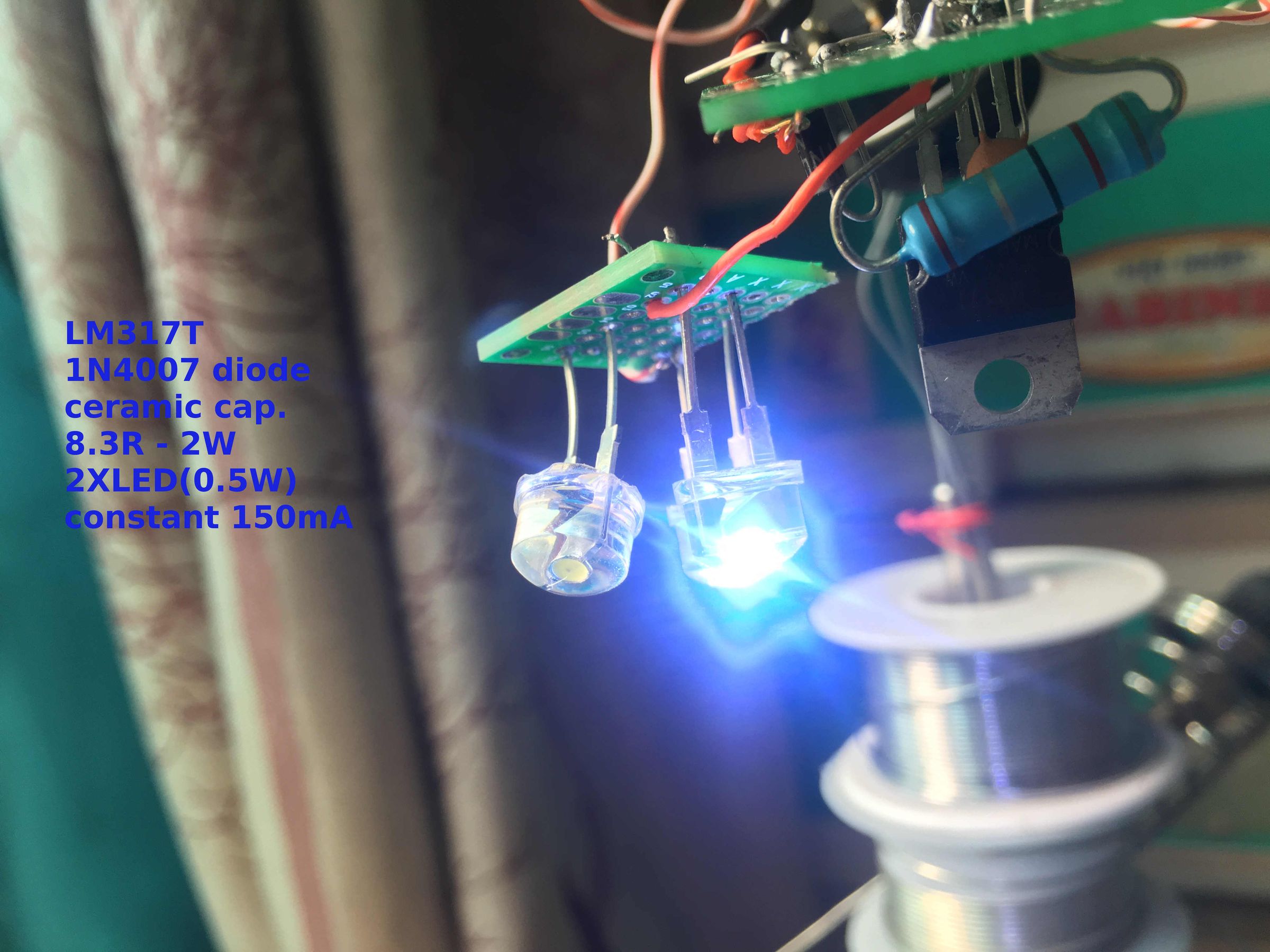

Step 11: An *even Simpler* Current Source
ok, so it turns out there's an even simpler way to make a constant-current source. the reason i didn't put it first is that it has at least one significant drawback too.
This one doesn't use an NFET or NPN transistor, it just has a single Voltage Regulator.
Compared to the previous "simple current source" using two transistors, this circuit has:
- even fewer parts.
- much higher "dropout" of 2.4V, which will significantly reduce efficiency when powering only 1 LED. if you're powering a string of 5 LED's, perhaps not such a big deal.
- no change in current set-point when temperature changes
- less current capacity (5 amps - still enough for a lot of LED's)
how to use it:
resistor R3 sets the current. the formula is: LED current in amps = 1.25 / R3
so for a current of 550mA, set R3 to 2.2 ohms
you'll need a power resistor usually, R3 power in watts = 1.56 / R3
this circuit also has the drawback that the only way to use it with a micro-controller or PWM is to turn the entire thing on and off with a power FET.
and the only way to change the LED brightness is to change R3, so refer to the earlier schematic for "circuit #5" which shows adding a low/high power switch in.
regulator pinout:
ADJ = pin 1
OUT = pin 2
IN = pin 3
parts:
regulator: either LD1585CV or LM1084IT-ADJ

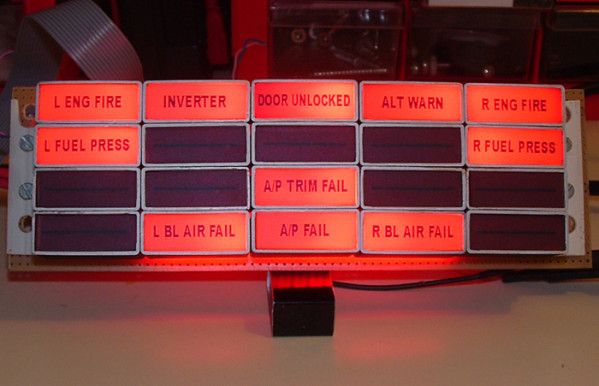

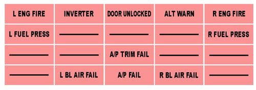

Bonsoir , je m'appel RAOUL , je suis maquettiste et modéliste . je suis en trains de faire un simulateur de vol .
Depuis un ans je suis dessus pour un avion Beechcraft 200 . les choses se complique maintenant car j'arrive au stade des éléments de contrôle. je cherche un système de metre des alarmes indépendant pour 30 petites cases des 30 mm x 10 mm avec un contrôle des voyants d'alarme par 1 bouton poussoir générale et Control par ranger par potentiometre poussoir ( LEDS de 3mm en 12 volts ) merci d'avance
Alarmes-Basses petit carré de 28mmx8mm a voir les espaces ! 3 copies.jpgAlarmes-Hautes petit rectangle de 32 mm x 12 mm .3 copies.jpgVisuel-rouge-6.jpg

I was looking the for a constant current LED driver circuit the other day so that I can understand the principle of LED driver. I had so many bad experience with the existing LED driver in the market, and I want to know why.
I am very fresh into electronics, please excuse my ignorance if I say something fundamentally wrong.
I did some study with the circuit and the part list. At first I thought the Q1 (N channel enhancement mode MOSFET) is supposed to operate at ohmic region which was regulated by the Q2 (NPN type BJT); however, I looked at the MOSFET data sheet, and it seems the resistance fluctuation due to the current flow from drain to source of the MOSFET is not sufficient make a difference (I used a 60V DC supply, with 300mA LED load as design parameter and size everything accordingly).
After some calculation, it seems that the only thing the MOSFET does is to stop the circuit with excessive current flow (on the order of 10 to 50 times the running current), and does almost nothing to the small current fluctuation.
Once again, I am very new to the electronic circuit design, and maybe I've interpret the datasheet incorrectly. I am hopefully I can get some insight from the experts like you concerning a little more detail about the calculation and the detail parts selection.
Thank you.
