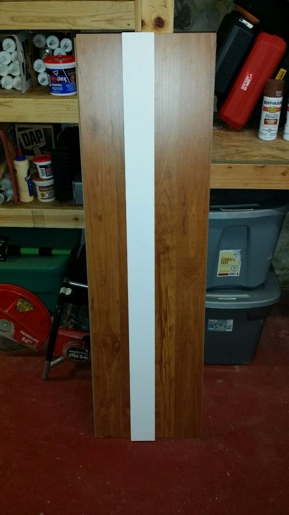

Rip guides like this one can be found on YouTube and in other Instructables here. They are very handy for precise ripping of large panels and for trimming things like doors. I am including a couple of modifications, though, that I think readers will find very beneficial. One is a cost reduction. A second is no need for making a precise cut during the construction of this guide. Another is a way to clamp the guide so the clamps do not interfere with the motor housing on the saw. The fourth is two working edges in case one should be damaged.
In the photo you see my rip guide prepared to trim 1/8 inch from the bottom of a door.

Have the store rip 15 or 16 inches from the long side of a sheet of 4 x 8 feet Masonite. It does not matter if the cut is not completely straight, but the panel saw will likely yield a straight cut. (My saw's base is wider than some with almost exactly 5 inches between the edge of the base under the motor housing to the nearest side of the saw blade. If your saw's base is smaller, the Masonite could be narrower. But, the Masonite needs to be twice as wide as the base dimension on the motor side of the base plus the width of the trim board. Leave a little extra on both sides to be trimmed away.)

Center the trim board on the long Masonite piece and clamp with "C" clamps. Support this sandwich with enough sawhorses to keep it from bowing.

I chose to have the saw base ride on the smooth surface of the Masonite. So, the rough surface will be down on the finished guide. Here you see the two pieces inverted for assembly. I measured so the screws would form a line down the center of the guide. A screw is installed about 1 to 2 inches from the end. Then I placed screws every 8 inches. The heads are countersunk so they do not scratch a finished surface in use.

Years ago I purchased a two piece aluminum saw guide for ripping. It deflects a little in the middle and I always had to buttress it from the side. Even then, it was not completely satisfactory. This guide from Masonite and an MDF trim board is so much better. When I need to cut something less than 8 feet in length, I just allow equal portions to hang over at the ends and it all works very well.
