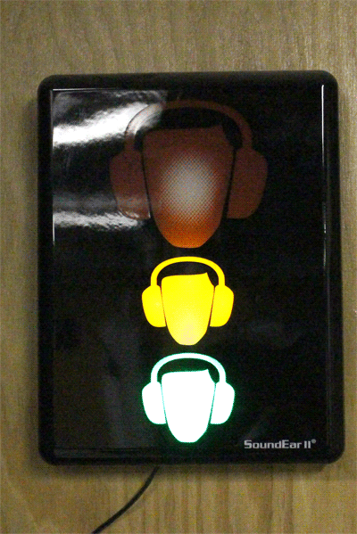

Step 12: Running the Centrifuge (aka "the Death of Hearing")
Running this centrifuge is loud. Very loud.
I've never used a large commercial centrifuge, so I'm unsure how it compares. Circular saws are loud to begin with, when it strained under the modifications it was never designed for the sound was deafening.
Imagine a high pitched grinding drone mixed with the sound of metal being churned in a blender. The piercing din seemed to bypass my hearing protection and pierce my brain.
The sound was so loud that there were concerned co-workers coming in from other areas of the building to ensure that the sound of a robot doing breakdancing moves was intentional and things were okay.
I ended up having to tuck the centrifuge away in small room and had to promise only to operate it outside of business hours.
