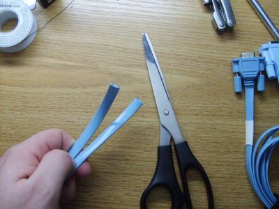

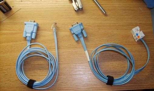

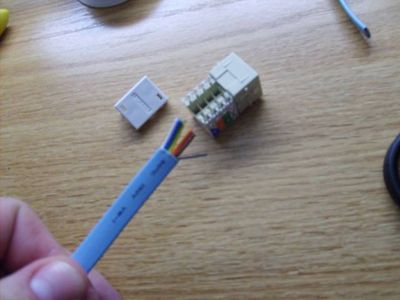

Step 2: Cut the Second Cisco Cable
Get out the scissors and cut the second Cisco cable in half. You can take the end that has the RJ45 jack on it and throw it in a safe place for some other project.
We are going to use the section of cable that still has the 9 pin adapter on it. Take the end of that cable and strip the wiring about half inch down.

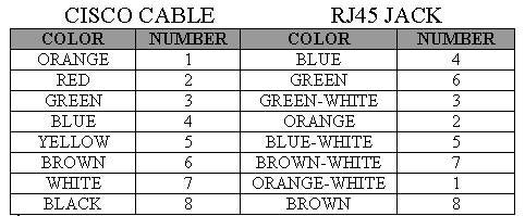

Step 3: Wire the RJ45 Jack
Now comes the tricky part. We need to match the wiring in the jack to be configured for RS232 null modem with full handshaking. I found this page very helpful when I was wiring: RS232 serial cables pinout
Some colors might vary on the Cisco cables (I checked the pile we had), but not much. White and gray are the only colors that I noticed changed in my stack of cables. You might want to grab your trusty multimeter and test the cables for your pinout diagram.
See the wiring chart picture for details.

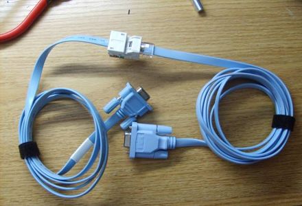

Step 4: Finished!
Once the cables are safely wired into the RJ45 jack, simply connect the first, untouched Cisco Console cable into the jack. TADA! You now have a quick and easy cable that can be used as both a Cisco Console cable or a Null Modem Cable!
