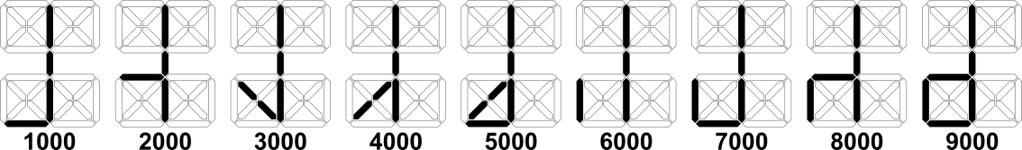

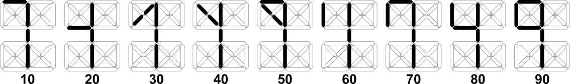

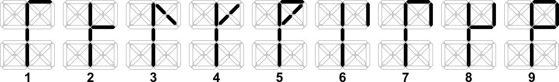

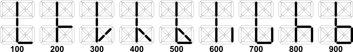

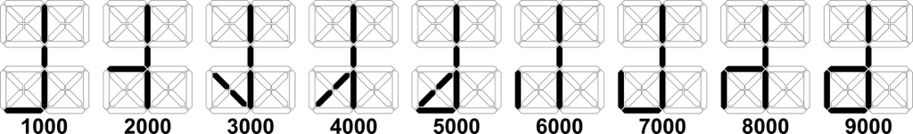

What is interesting in this system? The very compact way in which integers between 1 and 9999 can be written. All four digits are placed on a single character position. Of course, over time several forms of writing of this system were used, I chose one of them in this project, the form you can see in the graphs below.
the ones
the tens
the hundreds
the thousands
So 2317, 1245 or 0958 could be displayed as

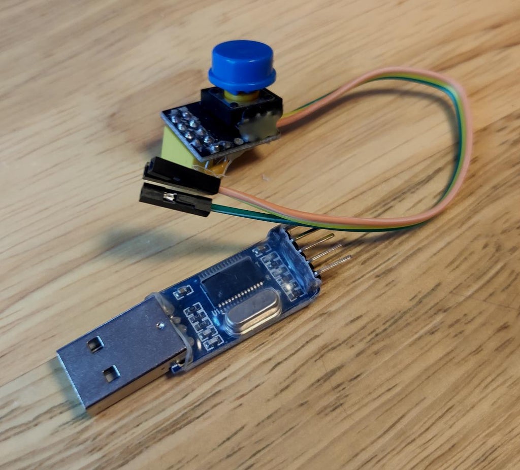

I used Arduino IDE 1.8.13, Arduino Core for ESP8266 2.7.4 and FastLED 3.4.0. With the settings you can see in the picture above the program is compiled and loaded in the ESP-01 module without problems.
