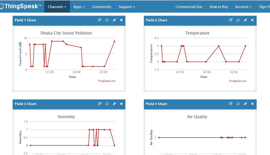

If everything goes well the device will start sending data to ThingSpeak. The graphs look like following
If this is the first time you are using ThingSpeak you may visit https://www.codeproject.com/Articles/845538/An-Introduction-to-ThingSpeak and https://roboindia.com/tutorials/thingspeak-setup.
