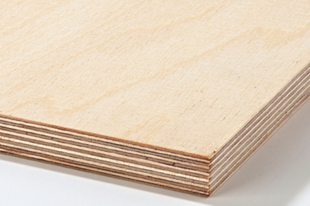

12 mm Plywood (80*60 cm)

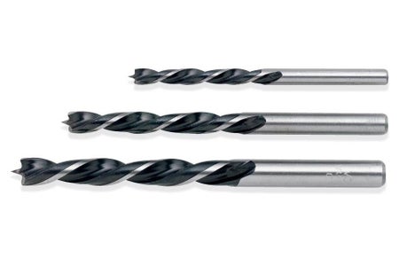

5.2 Wood drill bit
6 mm drill bit
10 mm drill bit

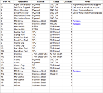

Brass tube - 7mm brass tube (5.3mm inner diameter, to fit M5 screw)

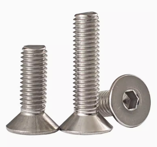

Stainless Steel Hex Drive Flat Head screws-

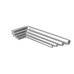

Allen keys set

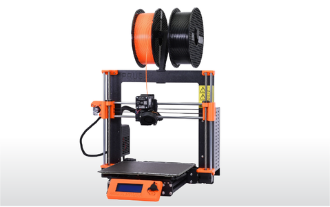

3d Printer with filaments-
- PETG
- TPU

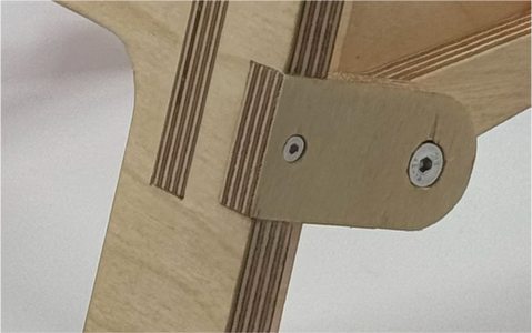

Step 4: Assembly & Bonding
Assemble the parts as shown in the picture
Ensure that all parts are fully inserted and align flush with the front surface
Use wood glue to secure it together
Let dry
Step 5: Assembly & Bonding 2
Assemble the parts as shown in the picture on both sides
let dry
drill 3mm hole through the 3 parts assembled
Countersink it using the 6mm drill bit
secure with the m3 screw (the small screw in the picture)

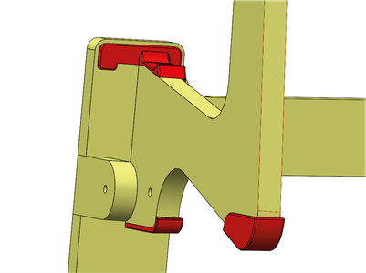

Step 6: 3D Print - TPU
3D Print these in TPU, choose a color that makes you happy.
for better results with TPU it is recommended to print each part individually.
Step 7: 3D Print - PETG
Print handles in PETG

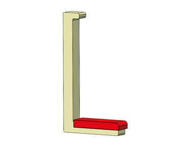

Step 8: Contact Cement
Use contact cement to adhere the printed parts as shown in the picture. Repeat the process for the other side.
Pay close attention, as the TPU parts on each side have a matching angle to properly adjust to the desk.

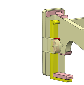

Step 10: Clamp Assembly
Place the clamp and clamp grip into their slot. Make sure you are using the correct clamp, as the clamp pad has an angle to properly adjust to the desk, just like in Step 8.

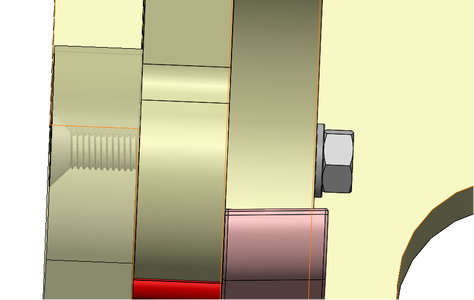

Step 11: Clamp Assembly 2
Place the tension arm in its position, ensuring it is set to 'open' (lifted upwards, as shown in the picture) to allow the M5 screw to be inserted. Secure it with a washer and a nut.
Repeat this step for the other side, ensuring the same alignment and secure fastening.

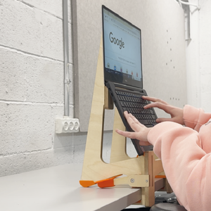

Step 12: Set It Up and Enjoy!
To set it up on the table, hold the clamp upwards against the stand with the desk surface in between (1). Then, lower the handle to lock it in place (2). Finally, place your laptop on the stand, and you're good to go!
