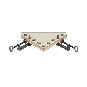

This clamping square was created as a lower cost alternative to the Woodpeckers clamping squares + CSP clamps and their multiple clones.
This design makes some tradeoffs:
  • It can only be used/clamped on the inside of a joint and therefore cannot be used to line up butt joints.
  • Both the square and the clamps are bulkier and harder to manipulate.
  • Lower precision. Initially it is entirely dependent on the squareness of cut, but wood is more likely to change over time than aluminum.
  • Squeeze-out may bond to the surface of the square if some countermeasures are not added (like packing tape).
Materials
  • Scrap material about 3/4" thick and enough for a >192mm square.
  • 2x Bessey TK-6 clamps.

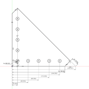

Step 1: Cut a Square
Cut a square with roughly 192mm sides as precisely as possible.
Step 2: Split the Square
Pick two opposing corners and connect with a line.
Step 3: Notch the Square
Cut off the same two opposing corners 23mm deep and perpendicular to the line.
Step 4: Split the Square
Cut the along the line centering it on the kerf.
Step 5: Mark the Holes
Mark a line parallel to each face 16mm from the face. Then, measure and mark each hole position every 32mm referencing the faces.
Step 6: Drill & Chamfer
Drill and chamfer 3/8" holes as perpendicular as possible. Also sand the corner between the two reference faces for glue clearance.
