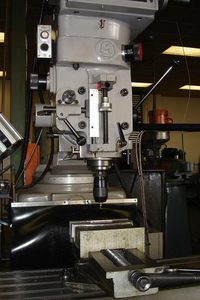

How many times have you gone through setting up your job in a machine vice, made sure everything is lying level and square, maybe even done a little machining - only to find that one of the holes you are drilling is going to penetrate into your parallels?

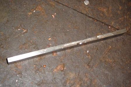

Make sure you have parallels that are slightly thinner than the parallels you are going to rest your job on (by 1mm or 2mm)

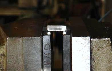

Place the wider set of parallels right up against the sides of the vice
Then place the thinner parallels on either side of the block you are clamping.
Finally you should use a rubber dead weight hammer to tap the job onto the wider parallels checking that they are held tightly by the job clamped ontop of them
This should ensure that your job is resting only on 1mm or 2mm of each parallel once the job is clamped allowing you to drill away to your heart's content without having to worry about hitting a hardened parallel
