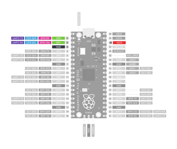

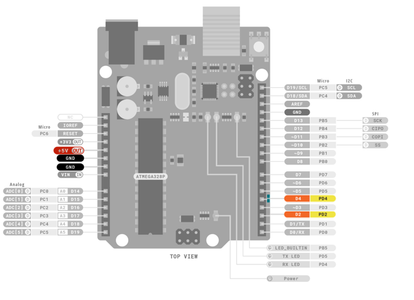

Step 3: Schematic Diagram
please see the diagaram above and the pinout to see where the parts need to go

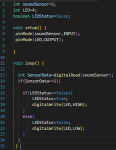

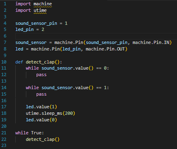

Step 4: Source Code
i have code for both the pico and arduino
