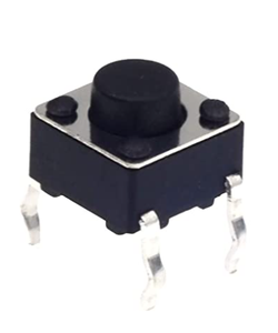

  • Push button (Link)

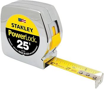

  1. Tools needed: Hand saw, tape measurer, ruler, pencil, plywood.
  2. To start, we need to cut the plywood sheet into the segments of wood that will be fastened together later to create the frame of the clapperboard.
  3. Utilize the tape measurer to mark 1 ¾ “ line from the edge of the plywood. Mark it at intervals along the entirety of one side of the plywood until reaching the other side, creating a long and thin section (Image 1).

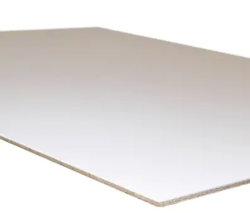

Step 3: Cut Out Whiteboard Front
  1. Tools needed: Whiteboard, tape measurer, hand saw, pencil.
  2. Here we will utilize the whiteboard purchased. We need to cut it out to make the face of the clapperboard.
  3. Measure out a mark at 2", 4", and 8", leaving two 2" sections and a 4" section. Draw the lines out past 12" horizontally.
  4. Next, place a perpendicular vertical line of 12" and make it intersect with the 8" line from above. Make a mark at 1.5" and 10.5" that are perpendicular to the previous lines in the middle section.
  5. Cut out the traced lines with the hand saw to be left with 5 pieces: one 12"x4", two 1.5"x2", one 9"x2", and a 12"x2". Discard the 9"x2" section, this will be where the 7 segment display is placed.

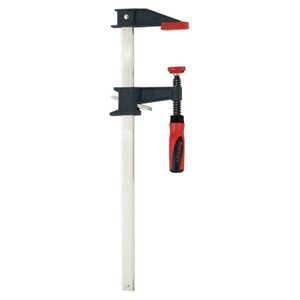

  1. Tools needed: Electric drill, 4 screws, wood glue, duct tape, cut plywood, cut whiteboard.
  2. Now the entire frame needs to be glued together to create the clapperboard base. The wood glue, screws, drill, tape, and all the plywood planks are needed (Image 1).
  3. Place the 12"x1.5" and 8"x1.5" planks in a rectangular frame like shown in the second image.
  4. Place wood glue at all the joints and gently tape the board together to hold. Let dry for 30 mins.
  5. Remove the tape from the frame and ensure it is secure. If not, check back every 1 minutes until dry.

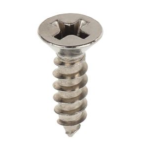

  7. Gently place guider holes and screw in the 4 screws to the frame, creating an open box shape as shown in the image.

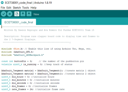

Step 7: Loading the Code
1.    Tools needed: Computer, Arduino
2. On your computer or laptop, please download the Arduino software linked here.
3. Open the Arduino software when the download finishes.
4. Connect the Arduino with its cord into a USB port on your computer or laptop that has the Arduino software.
5.    Copy the code included below into the Arduino IDE:
  Written By Dawson Reprogle and Ava Romero for Purdue ECET38001 Team 15
  Description: Program runs clapper board code to display time and frames to
  the 2 7-Segment Displays.

6.    Under the tools tab, then select the board as “Arduino Uno”. Also under the tools tab select the Port then “/dev/cu.usbmodem14101 (Arduino Uno)”
7.    Now you’re ready to compile and upload the code to your Arduino. Do so now by selecting the buttons.

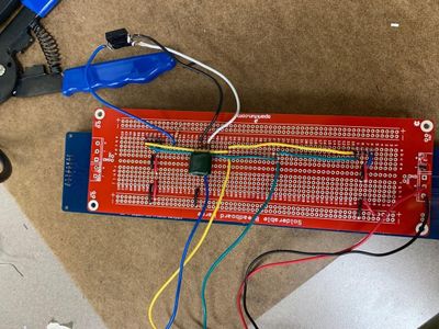

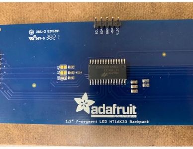

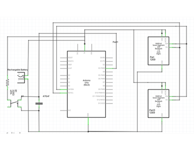

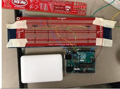

Step 8: Soldering the Board Together
1. Tools needed: Schematic, 7 segment displays, protoboard, soldering kit, Arduino, wires, wire cutters.
2.    On the right-most (when display is facing you) 7-Segment solder the A0 pins on the back together as shown (Image 2).
3.    It is recommended that you set your soldering iron to 350-400 degrees Celsius. Make sure to solder all wires to the protoboard before soldering the 7-Segment Displays. The wires should be connected as shown (Image 3). Helpful hint: Do one color of wire at a time to keep yourself organized.

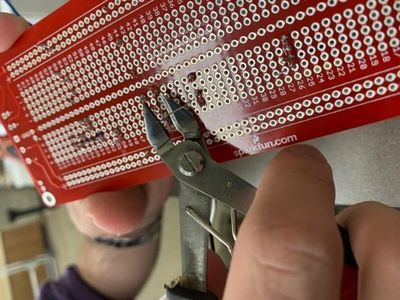

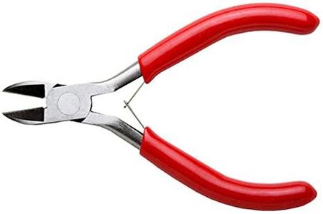

1.    Cut wires using wire cutters and wire strippers to size as you go.
2.    Work on one wire at a time.
3.    Tape down pieces that you are soldering so they do not budge while you are working (Image 4).

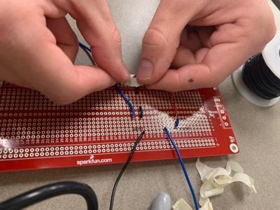

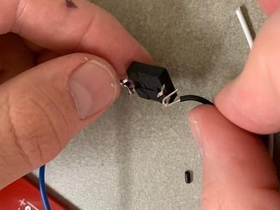

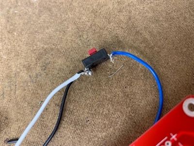

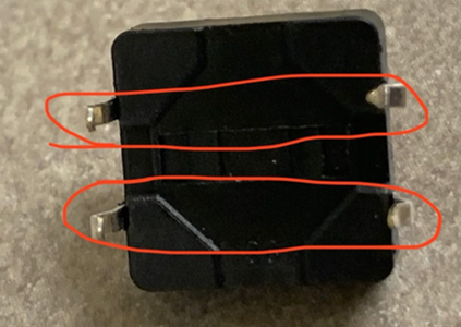

Step 9: Establishing the Push Button Connection
1. Tools needed: push button, protoboard, wires, soldering kit, wire cutters, 7 segment displays.
2.    The pins in the same red circle indicate that those two pins are connected to one another (Image 1). On the schematic where 1 on the pushbutton is labelled are the two left most pins in the image.
3.    In order to solder the pins you will need to wrap the wire around each pin as shown (Image 2).
4.    Once the pins on the pushbutton are all soldered it should look as shown below (Image 3).
5.    Make sure to trim all excess headers before soldering the 7-segments (Image 4).
6.    Now the board should look as shown (Image 5).
7.    Now you may solder the 10 7-Segment pins to the protoboard as shown.
