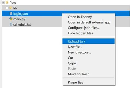

Upload the Code to the Pico W
- Open Thonny
- Display files by checking "Files" in View > Files
- In the bottom right where it says a Python version, click on it and select the one that appears as either "MicroPython RP2040" or "MicroPython Raspberry Pi Pico"
- In the files dialogue on the left, navigate to where you downloaded the code to your computer
- Select all the files and folders in the Pico directory, right click on them, and press "Upload to /," as shown in the 1st picture
- The code should now run on startup

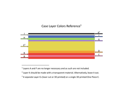

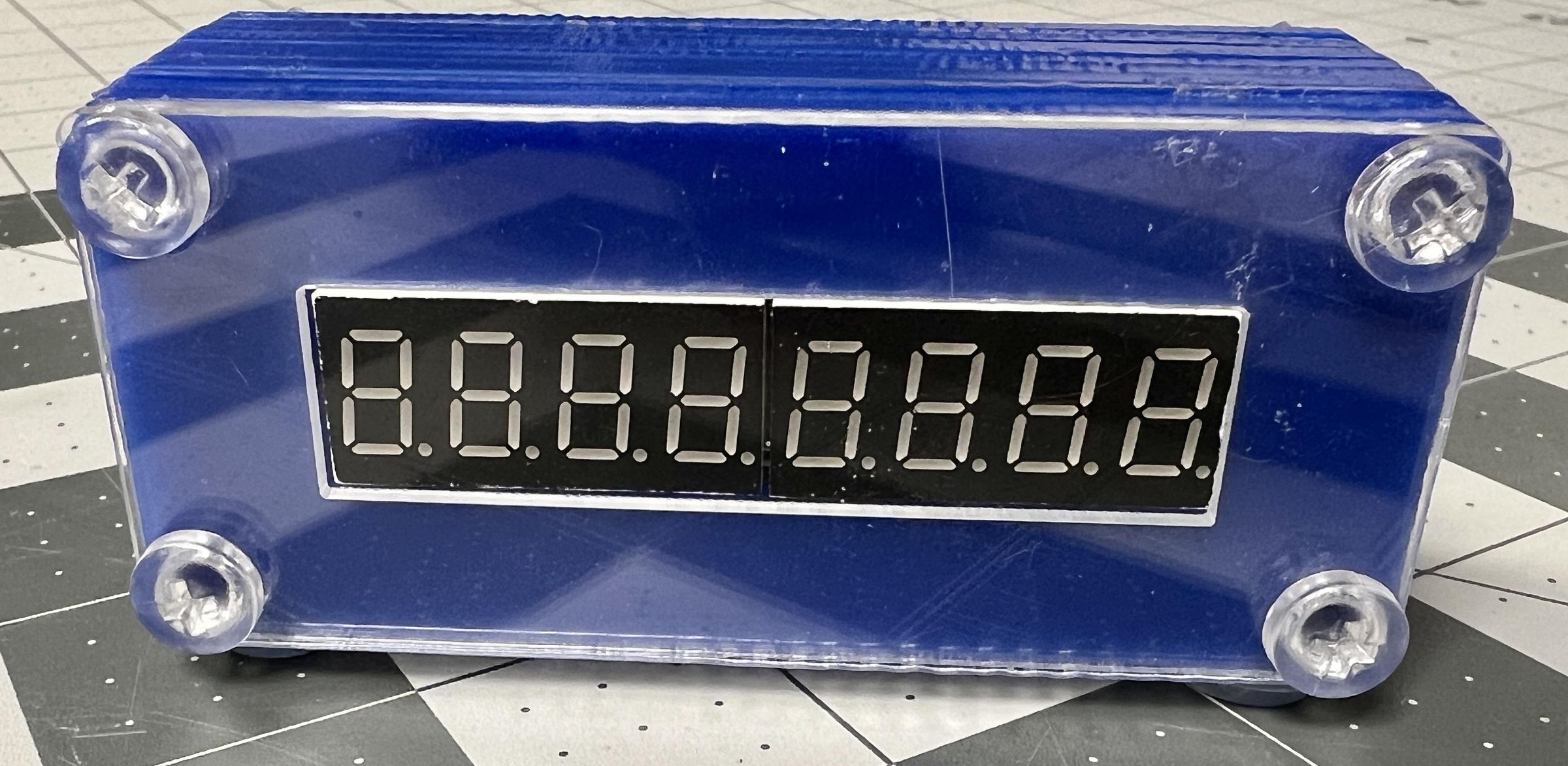

Step 6: Clock Assembly
I created instructions for the clock assembly based on the Fusion 360 model in Cadasio.
The layers have been color-coded to assist with assembly (also shown in picture):
- B: Red
- C: Pink
- D: Orange
- E: Yellow
- G: Purple
- H: Green
- I: Blue
- J: White
- K: Black
You can access these instructions with their animations online: https://instructions.online/?id=4231-class%20countdown%20clock.
Attached below are these same instructions as a pdf.
