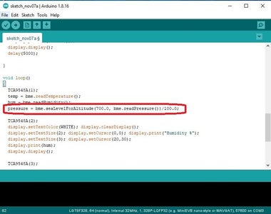

  If we want to display the Relative value of Atmospheric Pressure specifically for the area in which we live, we should in the part of the code
pressure = bme.seaLevelForAltitude(700.0, bme.readPressure())/100.0;
 to put the appropriate altitude (in my case it is 700m). I also made a version of the code where the values are displayed in larger digits, but without decimals.
