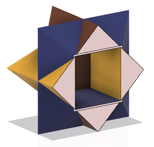

Step 3: Fixing the Overlap
Since these bodies are overlapping, our current shape can't actually exist in real life, so it has to be modified. Creating a sketch on the side of the yellow octahedron and projecting the edges of the blue one allowed me to create a construction plane at their intersection. I used it to lop off the top of the yellow one with a split body, mirroring the change on the other side and removing the extra bodies created. I also removed the blue and brown bodies, opting to copy and rotate the yellow one a couple times again to update the shape.
With just the yellow and blue bodies visible, I could see things start to come together. I cut the blue's shape out of the yellow with the combine body tool. Interestingly, this results in a single body instead of 2 because the corners are still touching. Despite that, I couldn't split it with an origin plane to make it into 2 bodies with an origin plane since the intersection is infinitely small. As a workaround, I created a sketch with a rectangle and extrude-cut one side away.

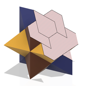

We're now left with a single piece that's ready to be mirrored, copied, and rotated again. There's no overlap left, but we can see with a section analysis that there's a cube-shaped hole in the middle now.
Step 4: Finishing a Piece
There's 6 pieces and a cube-shaped hole in the middle of them, which makes filling the hole pretty straightforward. I rolled the timeline back to before copying the piece, that way any changes I made would update the rest of the pieces. By lofting the inside face to the origin, we create another pyramid shape that, once copied, will fill the cube-shaped hole.
Now we've got Escher's Solid modeled with 6 individual pieces and no overlap. However, it's not quite ready. Since it's modeled to be geometrically perfect, there's no clearance, which means the pieces won't fit together in real life. But we're making progress!
