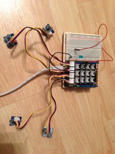

Summary: School classrooms are increasing the size due to budget. Teachers have difficulty in controlling the class.By using this noisy table locator teachers can easily identify noise location. This would point out one or more students who is creating distraction to class. This was built using Edison board.
Solution: Simple and inexpensive Noisy table locator can identify noisy table locator using 4 sound sensors. Four sensors are installed at each corner in the class and are connected to Edison board. Edison board running node js based would take reading from sound sensors, depending on the intensity of sound from 4 corners, processor would identify the location which would be shown to Teacher.

Step 1: Connect 4 Grove Sound Sensors to 4 Analog Ports
Step 2: Using Supplied IDE Program to Read Sensor Values
Step 3: Simple Algaritham Indicate Which Table Is Making Noise
Using sound reading from 4 corners of the room & simple calculation, we can identify table creating noise.
