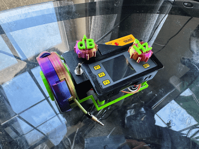

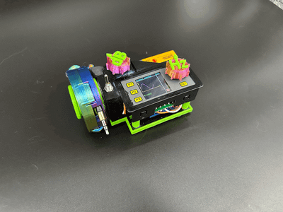

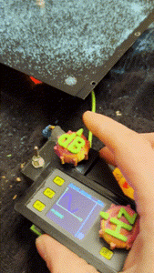

Step 1: TONE GEN MODULE: Prep
The WSFG-06 Tone Generator Module will generate the sine wave for our experiments. The button labeled 'P3' will put it into sine wave mode.
Super glue magnets onto component brace and winder magnet mount.
Use double-sided tape to adhere the LM386 module to the bottom of the tone generator.
Super glue screw posts at each corner of the bottom of the tone generator.
Tinkercad project with 3d prints
All of the STL files for the Tone Gen 3d prints are attached to this step.

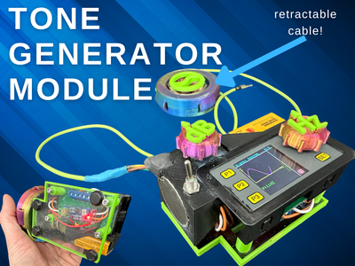

Step 2: Wire Tone Generator to LM386 Amp
Solder wires to the four pins on the end of the LM386 and connect them to the tone generator as shown in the image.
Step 3: Assemble the Retractable Cable
Feed the TRS cable into the component bracket. Cut the plug off of one end of the cable and strip the cable to expose the 3 wires inside. Identify which is the tip/ring/sleeve. Strip the 3 wires and solder a wire to each.
Solder the wires from the TRS cable to the switch and pot as shown in the image.
Step 4: Finish Wiring Switch and Volume Pot
Connect wires to the "OUT" and "GND" screw posts on the LM386, then solder them to the volume pot as shown in the image (OUT to lug 3, GND to lug 1).
Connect two wires to the switch; one will go to the LM386 VCC, the other will go to the battery +
Step 5: Assemble Enclosure; Finish Wiring
Super glue the component brace under the lip of the tone generator. Hot glue the 9v holder next to the component brace, making sure that the leads to the battery are still exposed.
Solder the wire from the middle lug of the switch to the battery +, and the wire from the bottom lug of the switch to the LM386 VCC. Connect the battery - to GND on the LM386.
See the image for full wiring scheme.

Step 8: Assemble Winder; Attach Knobs
Assemble the cable winder as shown in the image. Tone generator module done!

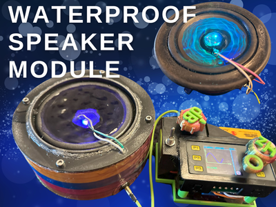

Step 13: WATERPROOF SPEAKER MODULE: Prepare LED
I made four of these with speakers of different sizes: 2", 3.5", 4.5", and 6". Attached are files to 3d print each of the enclosures, and their respective tinkercad projects are linked below.
To make the 'water in speaker' experiment more effective, we'll put an LED inside the speaker beneath the water by enclosing it completely in resin.
-solder 1k resistor to short leg of LED
-solder a wire to the long leg of the LED, and another to the other side of the resistor
Enclose in resin and cure. I used a small mold meant for chocolate (I think?) but the corner of a clear plastic bag would also work.
Test to make sure the resin is watertight: light the LED by touching the ends of the wires to either side of a 9v battery. Then, submerge the LED in water- if it stays lit, you're good!
Tinkercad projects for enclosures:
All of the STL files for the Waterproof Speaker Module 3d prints are attached to this step.
Step 14: Install LED; Spray
Feed the LED wires into the speaker, and press the LED gently onto the dust cap of the speaker.
With the LED pushed down, hot glue to secure it in place
Spray on a couple coats of the waterproof sealant and let dry
Step 15: Wire LED to Speaker and Jack
Install jack in enclosure, and solder to speaker and LED as shown in the image (wiring scheme is the same as the Chladni module)
Step 16: Seal It Up!
Seal up any gaps where water might get through. Hot glue and plastic bags work well, just be careful not to get glue on the speaker cone.

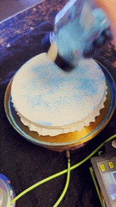

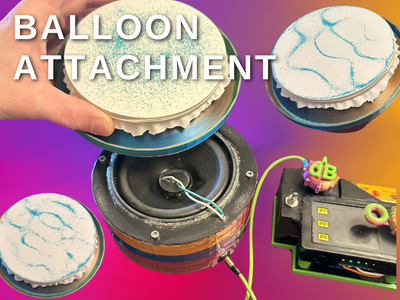

Step 17: BALLOON ATTACHMENT: Attach Balloon
Cut off the part of the balloon that you blow into, then cut a slit so that the balloon can be laid flat over the printed attachment
Stretch balloon evenly over attachment and secure with a rubber band.
Tinkercad projects for prints:
Step 18: EXPERIMENT TIME!

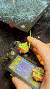

Tone generator:
The tone generator module is the brains of the operation, it sends the tone to whichever module is connect via the retractable TRS cable. The button labeled 'P3' on the tone generator will put it into sine wave mode.

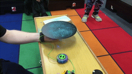

Chladni module:
Screw the plate onto the Chladni module speaker and sprinkle some sand evenly across the plate. Fire up the tone generator and see what happens!
Can also be used upside down! Try placing it upside down on a large drum, add sand and watch the patterns. The patterns will change as the speaker is moved around on the drum.

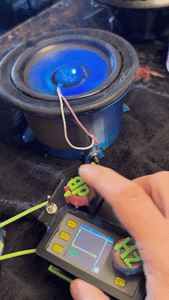

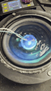

Waterproof speaker module:
Just add water!
Balloon attachment:
Simply set on top of one of the waterproof speaker modules and sprinkle some sand onto the balloon. Fire up the tone generator and watch the sand move!
