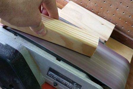

Step 3: Smooth the Edges
I used the router to round the edges of the blocks then put them on the belt sander to bring them down just a tiny bit more for a nice snug fit.
