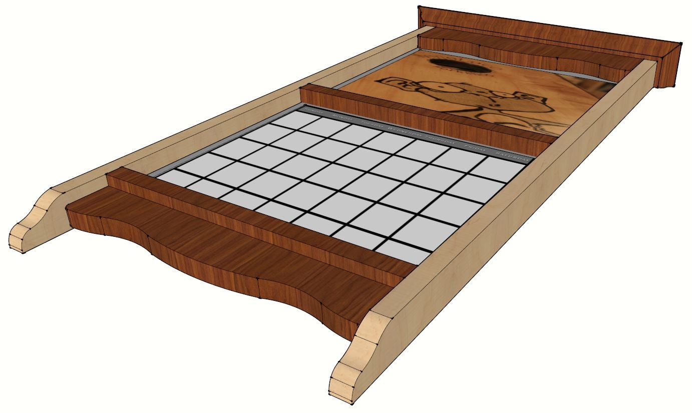

*The attached plans are for the calendar frame with the through tenons. If you don't plan on making this version you can simply ignore the mortise and tenons and all other measurements will be good.

Step 1: Cut Out the Parts
If you didn't start off with some 1-by stock you'll have to prepare your wood to get it down to about 3/4-inch thickness. Using the plans that you hopefully printed out in the first step, cutting the 7 different pieces that make up this project should only take a few minutes on the table saw.
At this point you might want to lay it out to make sure everything looks right. It helps if you can use the calendar as a reference in case your's doesn't match the standard Lang calendar dimensions. (Even if you have a Lang calendar, you might still want to lay it all out for a piece of mind.)
Step 2: Add the Details
To get the curvy parts, you'll want to grab some paper, card stock or even 1/4" hard board to make a template. Cut it to half the length of the 13 5/8-inch stiles. This way, after your design is drawn and cut out, all you'll have to do is flip it over to get a mirror image. Transfer the design to the two stiles that needs it using a pencil. (Or whatever writing utensil you want.)
Cut out the designs using your bandsaw, jigsaw, pocket knife or extreme amounts of beating it with a rock and then give it a nice sanding with 220 grit sandpaper. To get a pencil groove you'll want to get out your router table and install a groove bit. If you don't want the pencil groove to go the entire length, mark the start and stop point on your router table's fence. Now you can slowly drop the piece down on the groove bit starting mark and lift it up at the stop mark. (You'll probably want to turn your router off and push the bit back just a bit off of the stop mark to keep from going any further on accident.)
