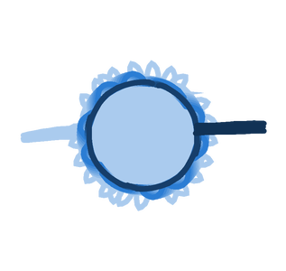

  • Inspired by the handle pictured above, I also extruded a couple of clay ropes in a straight line beyond the cup, hoping to connect the base to the cup during fabrication.
  • To achieve a lopsided appearance, I designed a couple of semicircle layers that would mark the transition between each cup. I then drew a completed circle on top of these so that one side of the cup would always be higher than the other, giving the appearance that the cup is slightly inside the previous.
