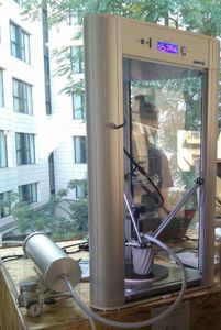

Step 4: Print
to print the botijo I used a WASP 2040 with CLAY extruder,
using a 2mm nozzle with a 0.6 layer height I have a really good result

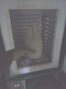

Step 5: Firing
Like all kinds of Clay you have to fire the piece, in this case paperclay needs a 1250 degree oven, in a ceramic shop you can choose what kind of temperature you needs in base of your clay
