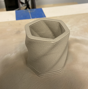

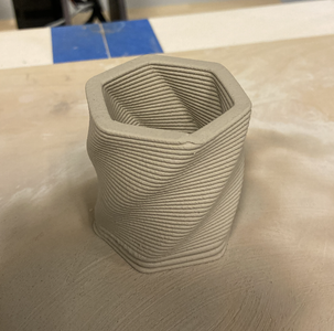

Step 3: Final Result!
After a few printing mishaps and fixing of the settings, we were able to obtain a beautiful final model! We printed out another one in which the base was not as clean because we did not account for the change in heights of the new surface we put in, but both pieces came out beautiful in the end. We printed a bowl as well to explore other designs Potterbot was capable of to create a basket look.
