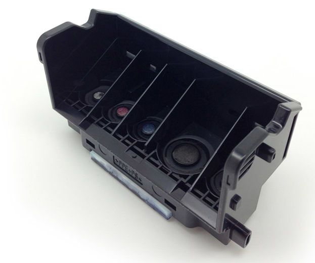

This Instructable is written specifically for cartridges with a printhead (printers with only 2 cartridges). This guide is specifically for HP products but is very similar for other brands. This guide first appeared on the blog of Inktweb.nl and has been translated for Instructables.
