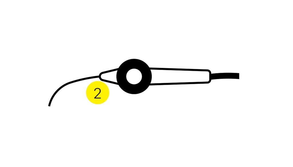

- Ensure that the small end of the water valve is pointed at the spray wand you wish to use. Hold the spray wand securely.
