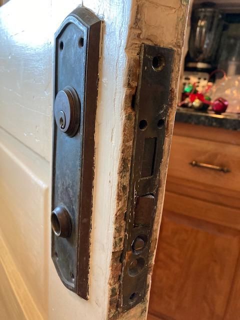

Step 8 (or maybe Step 7.5): My 87-year-old hardware set includes a keyed cylinder on the outside face of the door that is part of the lock case. I have removed the thumb turn on the inside (came off with the inside face plate) and I have the key for the cylinder, which turns the deadbolt, although when the deadbolt is thrown the key won't come out of the lock. But the keyed cylinder seems to be preventing me from extracting the lock case from the door. How do I remove or re-orient the cylinder so that I can extract the lock case? I cannot remove the face plate on the outside face of the door because the keyed cylinder holds the face plate in place.
Answer 12 hours ago
Have you tried unscrewing the back plate, then rotating the entire plate and cylinder as if you were unscrewing the cylinder, I.E. counterclockwise? The cylinder may be screwed into the mortise lock and may or may not be part of the backplate.
Answer 1 year ago
There should be a screw that you can backout to be able to rotate the cylinder and remove. Use a slotted screwdriver and insert in the hole on the door edge.
Reply 1 year ago
Worked like a charm! Thank you for the insight! I had removed the screw but didn't try (or try hard enough) to rotate the cylinder; but I've just removed it and reinstalled it, to make sure I could put it back in. Now the fun begins. . . .
