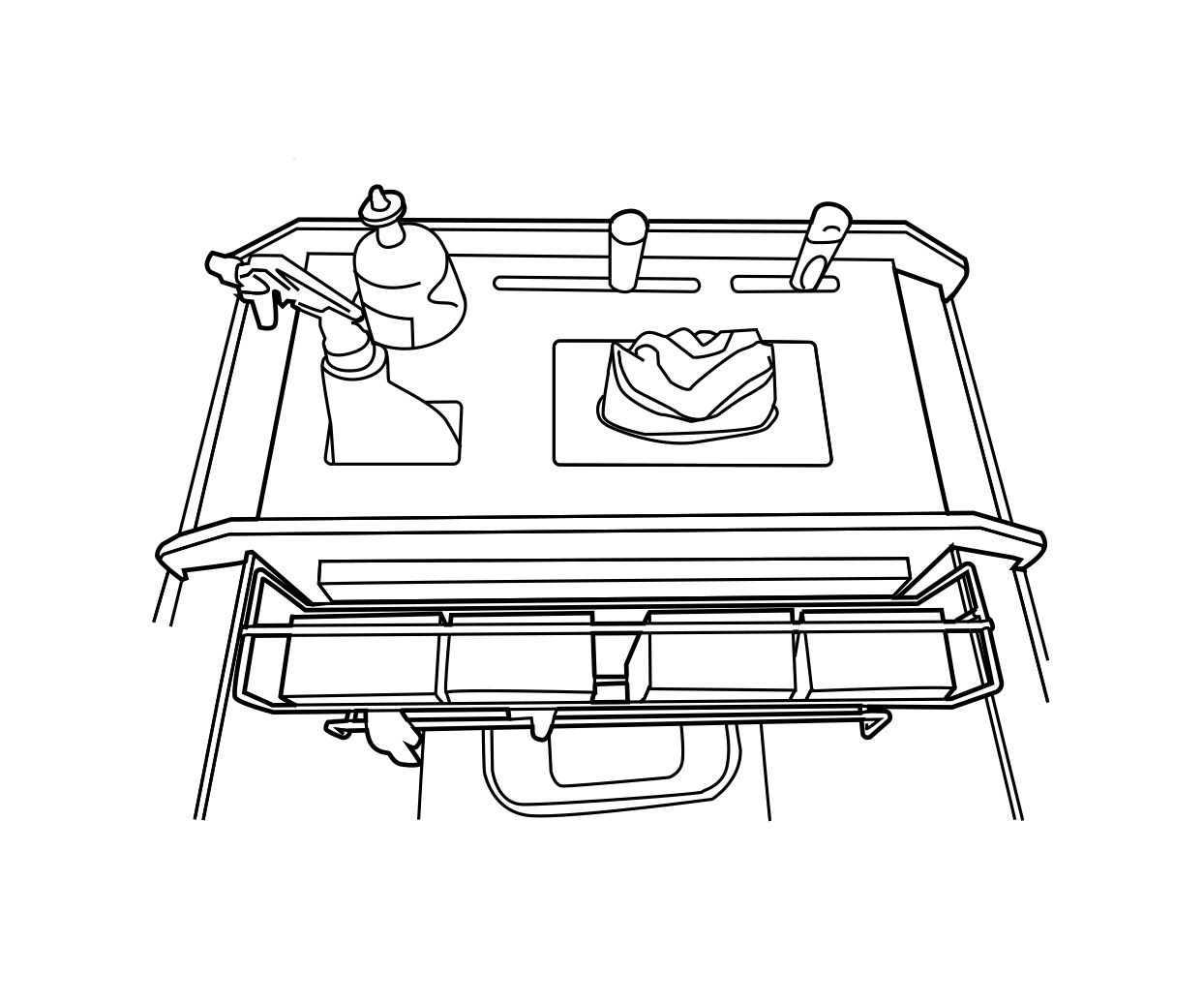

At the Pier 9 Workshop, a printer cleaning station is next to each printer. It’s stocked with water, alcohol, scrapers, microfiber cloths and gloves.

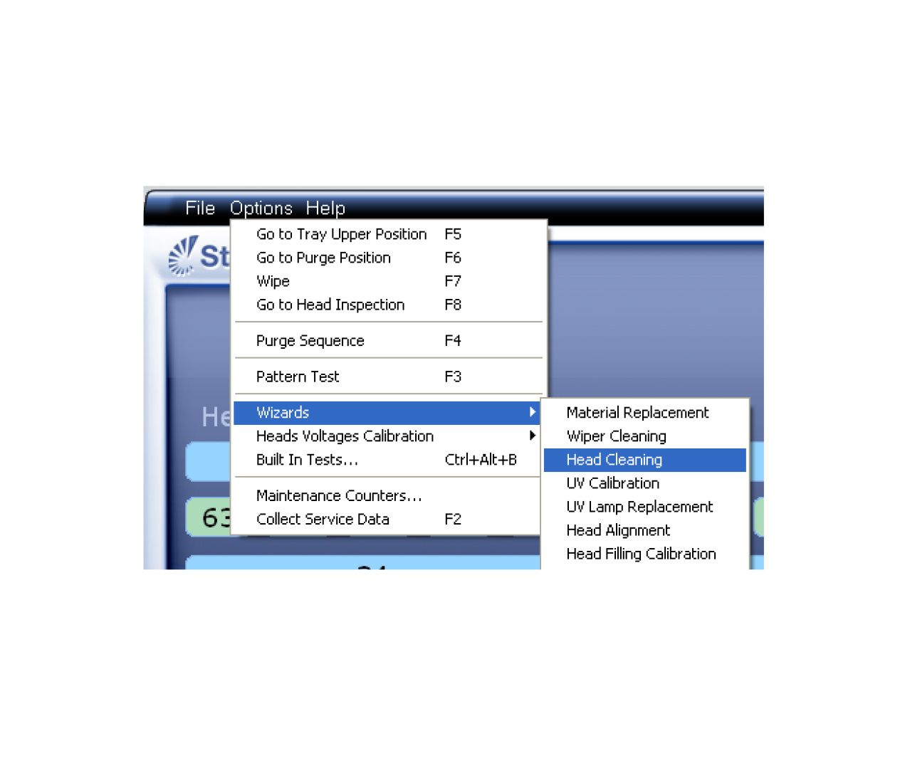

Run the Head Cleaning Wizard
Use the On-board Computer.
- Select Options > Wizards > Head Cleaning
- Follow the instructions to move the head into position.
- Ensure that the tray is empty and the door is closed.
- The tray must be empty to avoid a head collision.
- The tray will lower and the print head will move to the center of the machine.
- The wizard will ask if the heads are clean.
- The heads are not clean yet.
- Do not click yes.

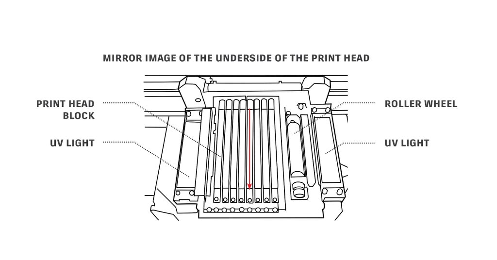

Clean the Print Head Block
- Fold a new, clean microfiber cloth into quarters.
- Moisten the cloth with alcohol from the cleaning tray.
- Wipe from the back to the front.
- Use firm pressure.
- See the red arrow in the illustration.
- Use a new section of the cloth for each wipe.
Note: If there is dried resin on the Print Head Block, see Shop Staff.
Clean the UV lights
- Use a new, clean microfiber cloth, moistened with alcohol and wipe the lens clean.
- If there is dried resin on the lens, see Shop Staff.

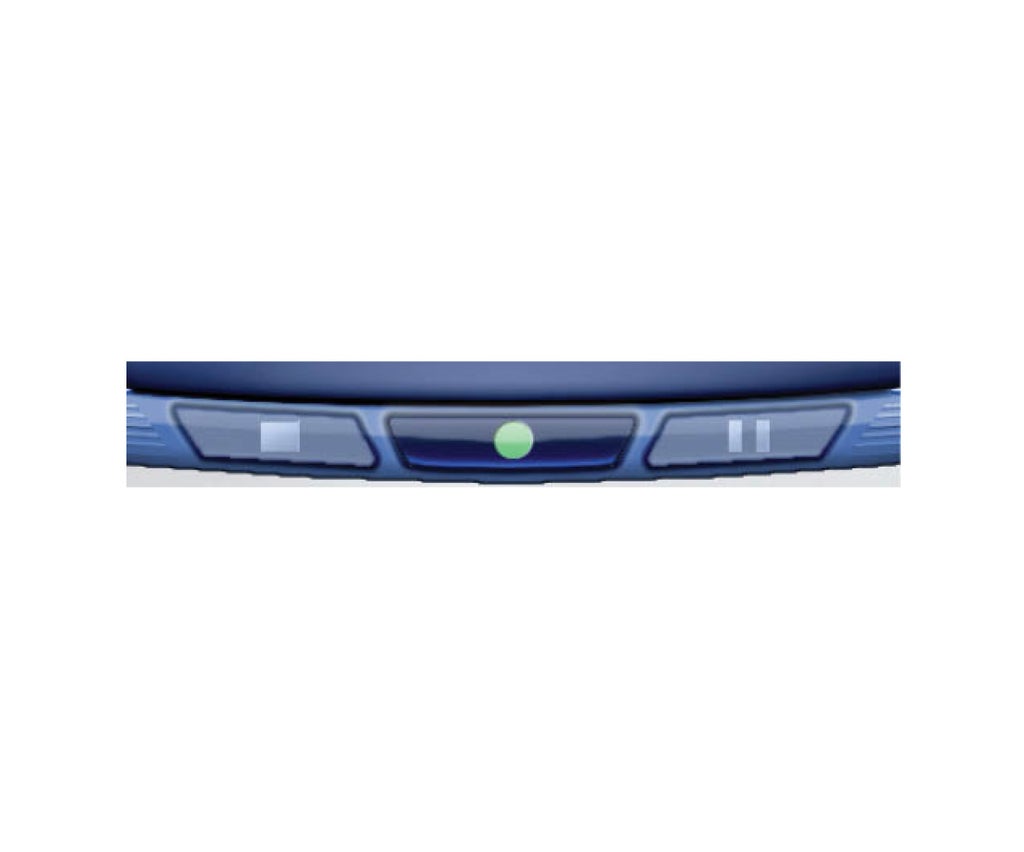

- Click the status button, and wait for it to turn green.
