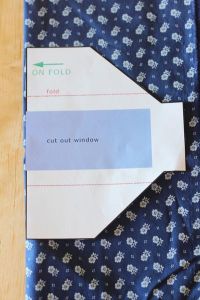

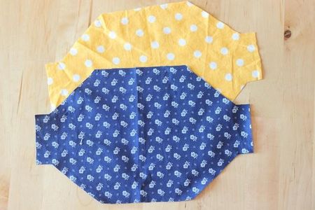

First you need to print the pattern. It might take a while until you find a face mask that suits you best and it’s the same with the sized. I’ve made the pattern in three sizes (two adult and one child) but you might have or want to make the pattern larger or smaller. You can do so by simply adding or taking from to the straight parts of the pattern (top, bottom and sides).
1. The printed pattern is a half of the mask. So you have to place it on the fold of the fabric and cut it out.
2. You’ll get the full form of the mask. Cut two layers, onw will be for the outside and one for the inside.

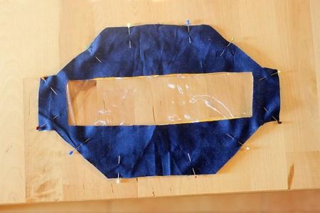

Step 2: Clear Window

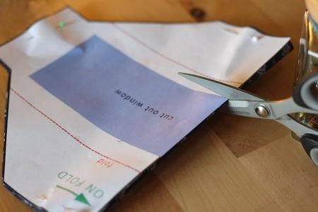

1. Fold both pieces in half again and place the pattern on them. Cut out the clear window. You can even cut it smaller if you want your 3D face mask to be less clear.

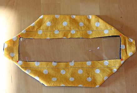

2. Fold both mask pieces to the wrong side where the dashed line shows and press. It’s easier to do with a ruler. 3. Fold both edges in, press and open.

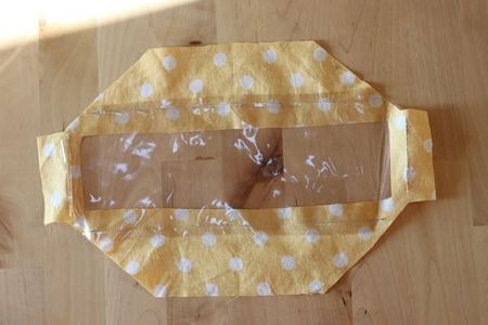

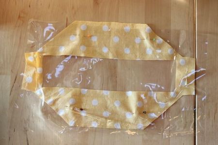

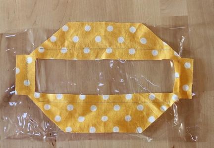

4. Place a larger piece of the vinyl foil and pin it to the wrong side of the inner piece. Place the pins further from the edges of the window.

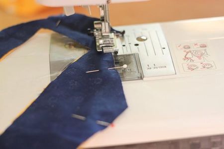

5. Topstitch where you previously made the folds and also on the short sides. Sew with the vinyl on top and set your foot pressure to low.
6. Trim the excess vinyl and round the edges to prevent them from pinching through the fabric.

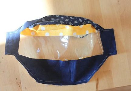

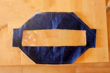

1. Place both mask pieces right sides together and pin.
2. Sew around the edges leaving just the sides open.
3. Although it’s not necessary to leave the sides open because you’ll turn the mask through the window hole, I find it easier to make a casing for the elastic band later if the sides aren’t stitched.

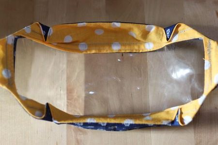

4. Turn the face mask right side out through the holw in the outside piece and press the edges. Be very careful not to come too close to the vinyl with the iron because the heath would melt the vinyl.
5. Topstitch in the same places like when you were stitching the vinyl to the inside piece. Then make diagonal 0,5 cm/0.2 in cuts in all the corners on both sides of the mask.

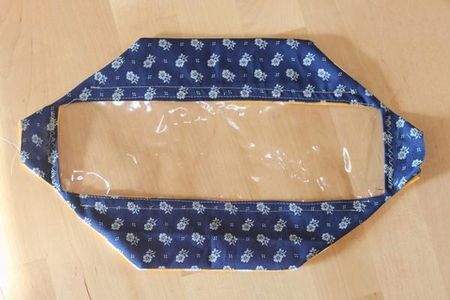

6. Fold all edges around the window in (on both sides of the mask) and topstitch. This will prevent them from fringing.

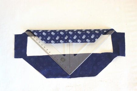

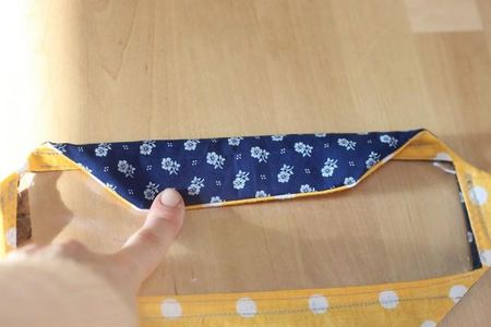

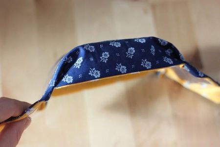

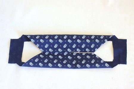

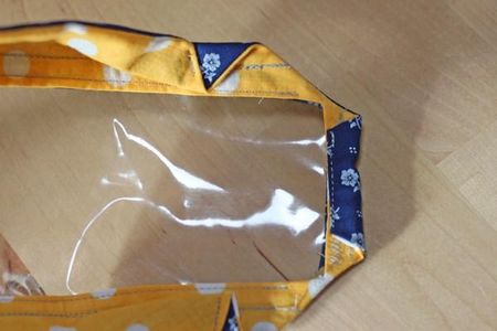

1. Fold the upper and lower edge in (same folds like you made before using the ruler).

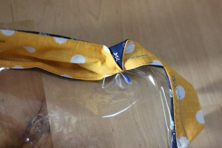

2. Pull the corner of each flap upwards (upper side) or downwards (lower side) to create a 90-degree angle.
3. Stitch.

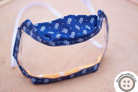

4. What you just did created the 3D effect of the mask.
5. Fold the sides in twice and topstitch. Now you have the casings.
6. Attach a safety pin to the lace or elastic band and feed it upwards through one casing and downwards through the other. Tie the ends in a know or sew together and your mask is done.
