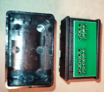

I bought one from Amazon for 25€.
You can also do it yourself with 2.54mm pin headers, is quite easy; are only few jumpers between the pins; you can buy fancy Molex original connectors, or simply breadboard it (see: https://www.jeepcherokeeclub.com/threads/diy-sgw-bypass.247203/)

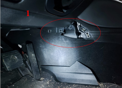

Step 3: Install SGW Bypass Module
The SGW module It's on the right side, under the steering wheel. It's easier to access from the bottom:
  1. remove the cover on the right (4 clips, gently pull with your hands)
  2. unscrew the two T20 torx screws of the bottom panel (right over the pedals)
  3. remove the bottom panel (gently pull from the right side disconnecting the front clips, then slide it out toward the driver seat)
  4. put your hand under the steering wheel column and disconnect the two connectors from the SGW module (for each connector, push the tab, gently wiggle and pull the connector)
  5. connect the SGW bypass module to the cables.

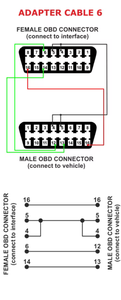

Step 4: Multiecuscan Gray Cable Adapter
I bought the complete multiecuscan "color" cable kit from Amazon for 30€.
Double check with a multimeter that your cable have the right connections, some chinese copy have same connections for all the different cable colors.
