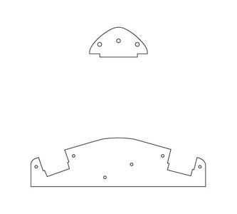

During the development of Farrusco , we tried a lot of different ways to attach components to PVC supports, from hot-glue, to screws and double side-tape. Because this is intended to be sold as a kit the main keywords were: easy, cheap, last long as possible, and as a final thought “less is more”, what you will see in the fotos below was how André Almeida solved the issue, all credits goes to him. As you see we are using PVC but this can be done with cardboard, wood, acrylic, polymorph, you name it..
We will show bumper-sensors and a Sharp distance sensor, there won’t be much to say, photos speak for themselves:

Step 1:
Starting with the bumpers, as you see they will fit perfectly inside the holes
Step 2:
Attach them with zip ties
Step 3:
let’s do the same with the Sharp IR
Step 4:
Fits perfectly on the pvc
Step 5:
use zipties to attach both to each other
Step 6:
fotos speak for themselves:
Step 7:
Use you components shape as an advantage and try to be as simple as possible.
