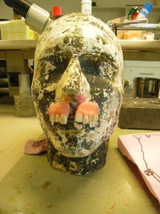

Starting with the splitted upper jaw:
These are regular acrylic teeth (ask your dentist or a dental laboratory for some (we´ve always got some to spare ;) ) OR make your own using Worbla’s Deco Art or whatever) which I casted in liquid plastic to form the gum. To make sure the final mask will fit on my face, I used a model of my own head, but you can also use a Styrofoam head instead. The teeth were glued on the model with hot glue. If you use a Styrofoam head, make sure the glue is not too hot or just use other glues instead.
postition the teeth directly on your upper lip. that way it will cover your lip and when you wear the mask later you can paint your lip black and you totally can´t see it then

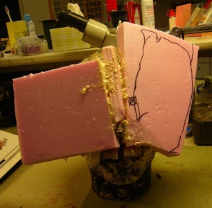

Than glue Styrodur boards onto the head model. you can use hot glue or expanding foam for that. Make sure you leave an empty space for at least one eye to see through the mask. the clickers have a skull fracture where the fungus cracked the skull open and swelled out of it. I put that crack over the position of my left eye. when you paint you panit your face black and close your eyes halfway people pretty much can´t see your eyes nor your skin. (you can see what I mean on the 3rd pic of this step)
Then roughly draw the forms on the Styrodur and carve them with a Stanley knife. For the concave parts I used a cooking torch to melt the material and give it a little texture.
Add piece by piece. You can also use expending foam to shape the parts that would be too difficult to carve. When you are pleased with the look, cover everything with Worbla’s Finest Art, to create a solid framework. worbla´s finest art is a thin thermoplastic. you simply have to head it up (I prefer hot air gun) and this stuff become flexable and stretchable. one side of it becomes sticky when you head it up. put that on the styro foam. Try to use as few pieces as possible to reduce ugly transitions.

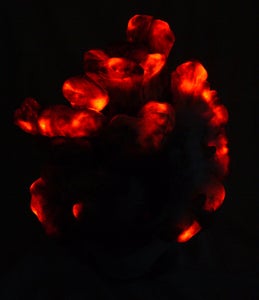

here you can see the glowing effect I was mentioning before (pic 1)
to get this effect I had to put 25 organge LED ´s inside the mask.
now you have to make space for the LEDs. you do that by ripping out some of the styro foam. to do that you can use a flat nose plier. just hollow out the parts you want to light up.
the LED circuit is a simple but massiv circuit^^ a lot of wires! don´t make the wires to short to make it easier to handle but make sure you don´t knot them while soldering.
each LED got it´s own resistor, if a resistor breaks down, the whole circuit won´t.
as a power source I used a 9V betterie block, it´s very small and I was able to hide it in the upper part of the mask.downside: it discharges pretty fast. I use cheap batterie and they last for about 2 hours. you can use what ever you want.
I build in a switch to shut it of easely
simply glue in everything with hot glue and that part is done
