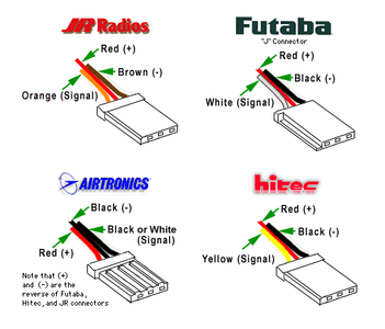

I was lucky to have nice Japanese robot servo Vstone VS-S092J. Take any from your helicopter, RC car or somewhere else. Regular motors or step motors would not fit with this schematics and program!
It is posible to go without breadboard. Just insert capacitor into servo jack. As you can see in diagram my servo is Futaba Style. Short leg (-) should be on black wire, Long leg (+) on the red wire. Grey wire goes to pin 9 on Arduino. Insert wires in servo connector in the same pins with capacitor. So red comes to 5V, black – GND.
