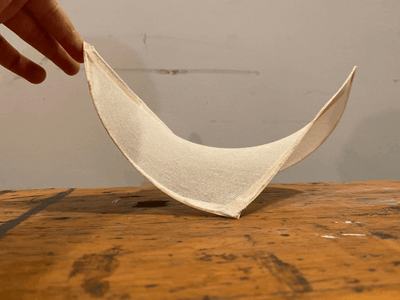

For the Manta, elastic fabric was stretched over a wooden veneer frame until taut. The veneer frame was semi flexible. The elastic fabric forces the veneer to be bent into an anticlastic form as the fabric attempted to relax itself. When the frames opposite adjacent corners were pushed together a "snap" effect occurred where the anticlastic form would reverse itself into a new opposite anticlastic shape. This back and forth snapping was the premise afforded to us by the two materials relationship with one another to which we would later use the flexinol wire to cycle through.
