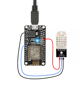

Step 4: Wire the ESP8266 and DHT22
Welcome to the easiest step! Before uploading code, let’s wire the DHT sensor to the ESP8266.
1. Wire The DHT22 To The ESP8266
Grab your jumper wires, and make the following connections:
  1. DHT VCC 3.3V pin on ESP8266
  2. DHT GND GND pin on ESP8266
  3. DHT DATA D5 pin on ESP8266
Double-check that you have done this correctly and that all wires are secure and fully inserted.
2. Power The ESP8266
Plug your USB to Micro-USB cable into your computer, and connect the micro-USB end to the one on the board. If powered correctly, an onboard blue light flashes briefly when plugged in. Note that only if the board already has running code on it, a faint blue light will show. However, don't expect this light to be super bright like seen on other microcontrollers.
Now the ESP8266 is wired and ready for programming.

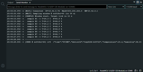

Next, you need to decide whether you want a reading every 1 or 5 minutes, and set the INTERVAL_MINUTES value accordingly:
// Minutes between sampling (replace number)
#define INTERVAL_MINUTES 1 // <-- set to 1 or 5
5. Upload Sketch
Click the arrow icon in the top left to upload the sketch. Once done, the ESP8266 should slow blink while it's trying to connect to Wi-Fi. You can also use the serial monitor at 115200 Baud for text updates. When connected to Wi-Fi, the light will fast blink 3 times. If this happens, that means the board is successfully connected to the Pi! If not, it's likely the password or SSID is incorrect. Additionally, the light will blink each time data is sent for visual confirmation.
6. Calibrate
This step only applies if you are reading data every 5 minutes. In order to get readings that are cleaner or on the 5-minute mark (4:00, 4:05, 4:10, etc.), you need to do this step. After finalizing placement of the board in your house, wait until just after the clock reaches a 5-minute mark (4:00:01 or 4:05:01) and then press the RST button on the board. This will ensure the internal clock will always send the data at these intervals.
Now your ESP8266 is actively sending temperature and humidity data to your Raspberry Pi server! You can now independently situate the boards anywhere in your house with the Micro-USB wall adapter. The final step is viewing the data on any device.

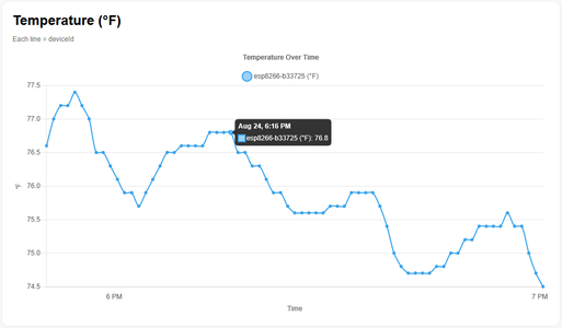

Step 6: Plug in the Pi and View the Graph in Your Browser
With Tomcat running on the Raspberry Pi and your ESP8266 sending data, the final step is to connect everything and see the results.
1. Hook Up The Pi To The Router
Use your Ethernet cable and connect the Pi to your home Wi-Fi router. Make sure to also power the Pi separately, as done before.
Important note: If you have a firewall, make sure to allow access to ports 8080 and 8081, or else this project will not work!
2. Find The Pi’s IP Address
Every router or network has its own interface, but the process is generally the same. Log in to your router’s administration page and look for the section that lists all devices currently connected to your network. Locate your Raspberry Pi in the list (it may appear as “raspberrypi” or a similar name) and note its IP address.
To avoid issues in the future, configure your router to reserve this IP address for the Pi. This ensures that the Pi’s address will remain the same even after it disconnects or reboots.
3. Open the Web App In A Browser
You can now access the Web App from any device on the same network. To do this, enter the following in a browser search bar:
http://{pi-ip}:8080/climate
Note: If the page doesn’t load, check that Tomcat is running (systemctl status tomcat10) and that your firewall allows ports 8080 and 8081.
You should now see the same graphs from before pop up. If everything is correct, data points should begin to propagate to both graphs on a page refresh. Data points will disappear after 48 hours so as not to cause a data leak. With this, the project is concluded. Congrats! Now you have a fully functional live climate monitoring system.
After running it in my room, I found that the results were undeniable. On some nights, my room was a whole 8 degrees Fahrenheit warmer at night than the rest of the house, which was proof that the heat wasn't just "in my head". With this data, I easily secured a more rigorous running of the AC in the twilight hours. Mission accomplished.
