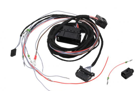

2.Wiring loom, you can take easly from the kufatec. Here the link: https://www.kufatec.com/en/comfort-retrofits/climatronic-cable-set-for-vw-golf-4-bora-33346

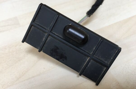

4.Sunlight penetretation sensor.

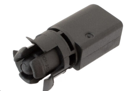

5.Outside temperature sensor.

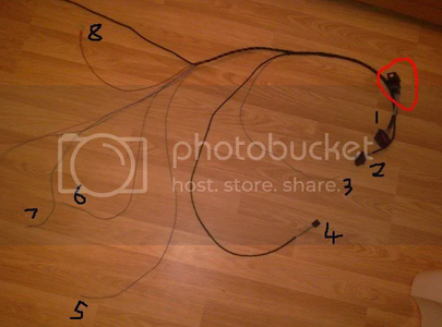

Now start with the wiring with the climatronic harness.
1.In the photo the connector circled in red you must attach with the exisisting loom of your car.

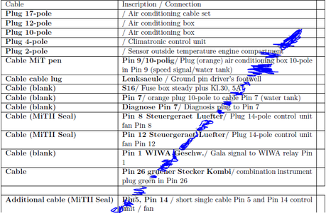

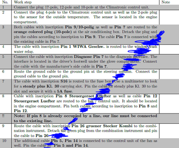

2.in the other 2 photo there are the ufficial kufatec wiring

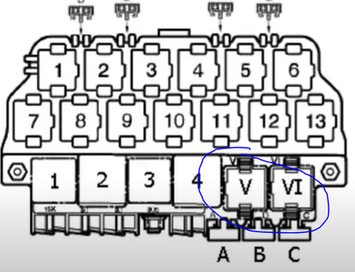

TIPS: the ground of the box fan you must attach to the A-pillar; in the photos with the layout of relay i circled in blue the WIWA relay.
