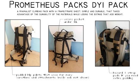

Introduction: Climbing Backpack W/ Frame and Pattern
Here is my first shot at making a DYI backpack project.
It can made from durable industry standard heavier materials (500D cordura or 840D Ballistic) on a home machine or very heavy duty materials on an industrial machine (1000D cordura or 1680D ballistic)
All the instruments (with build pictures), pattern and places to order materials from are on the pdf's below. I am trying to convert them to JPG's while keeping the scale the same and keeping them printable on a plotter.
