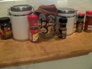

Once you have the the clock in the jar you need to find a piece of cloth or leather material to cover the top of the jar so you cant see the actual clock mechanism that makes the jar tick.
Step 8: Final Piece of Time
Once everything has been finished you can place the clock jar in your kitchen next to your other jars in order to have a good mix of time and jars.
