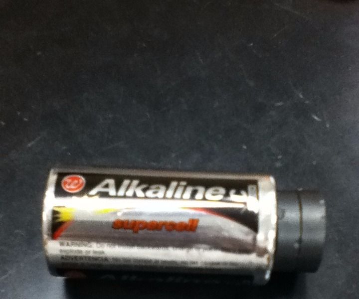

By now your clock should work.This step is to keep your clock safer and I recommend this step but it is still optional. The box that the materials came in (Sunfounder kit box) is what I used. What you do is stick the seven segment display through the top of the box and make sure when attaching the jumper wires to the pins be careful and make sure which wires go on the decimal side.Tape down the arduino and breadboard, install a battery pack and plug the USB cord in and your done!
