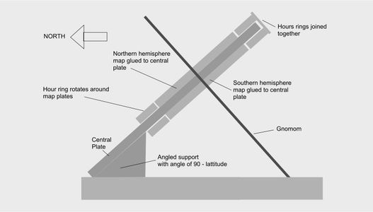

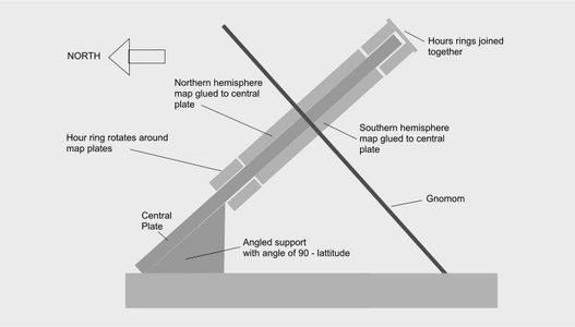

For the construction I used a central plate sandwiched between two map dials that are attached to that central plate with screws. The maps can be adjusted for the longitude by rotating the map till the longitude of your location is above the center line of the central plate.
The gnonom of the sundial points to true north and the whole plate is angled at an angle of your latitude subtracted from 90 degrees (Angle of plate = 90 - latitude). For greater flexibility the plate can be hinged so that the angle can be adjusted for different latititudes - I used a fixed angle which is for 49 degrees North latitude where I now live.

  1. Aligning the top and bottom map plates so that the longitudes were aligned and drilling holes for four screws in these map plates.
  2. The N hemisphere top plate was then stuck to the central plate with a piece of double sided tape with the center of the plate aligned with the center of the central plate and the longitude of my location aligned with the line etched on the bottom part of the central plate.
  3. Holes were drilled into the central plate using the previously drilled holes in the top plate as a guide.
  4. Four screws were partly inserted into the top and central plate and then the bottom S hemisphere plate was attached. The screws were tightened holding all three plates together.
  5. I then slid on the bottom numerical time ring onto the S hemisphere plate. Same with the top numerical hour ring onto the N hemisphere plate. Aligned the two rings together and glued them with scraps of acrylic that bridged the top and bottom hour rings. These rings can rotate around about 30 degrees (about 3 hrs worth) though they are connected to each other at their edges.
  6. Finally glued on the angled supports. BTW, by glue I mean acrylic welding cement, a liquid which fuses acrylic pieces together.

  1. Find a thick metal wire - I used a piece from a wire hanger.
  2. Bend one end of the wire to form a T- or L-shape. The T- or L-shape serves as a support for the sundial.
  3. Slide the wire through the central hole. The hole should be a tight fit around the wire.
  4. Rest the sundial on a known level flat surface (I used a bubble level to make sure that my kitchen table was actually horizontal) so that the angled pieces are in contact with the flat surface.
  5. Slide the wire till the T- or L-shape rests on the horizontal flat surface. Apply some glue to the central hole in which the wire, the gnomon, was inserted to prevent the wire from sliding.
  6. Find true North with a smart phone app and mark this on the flat surface to which you are going to attach the sundial. The flat surface should be checked with a bubble level.
  7. Attach the sundial to this flat surface with the gnonom pointing to true North. I used silicon adhesive to attach.
  8. Rotate the hour ring so that the cast shadow shows clock time.
  9. The hour ring needs to be adjusted once a week to correct for the difference between clock time and solar time.
