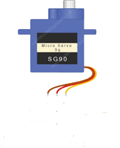

  6. 3x SG90 servomotor

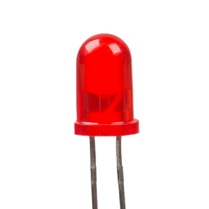

  14. LED

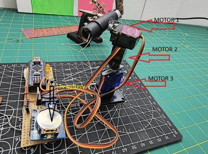

Step 1: Schematic Diagram
The electrical diagram is shown in the image above. The servomotors will be connected in the order indicated and following the attached photo. The laser diode is powered by a constant current circuit made with LM317. You can adjust the brightness of the laser beam in small limits from the 10k potentiometer.
Mount a 3V battery on the RTC 1307 module in the module's special slot. This will ensure the operation of the internal clock even if the supply voltage of the assembly is interrupted.
Connect + to the pointer housing, and - to the central connector, as seen in the photo.

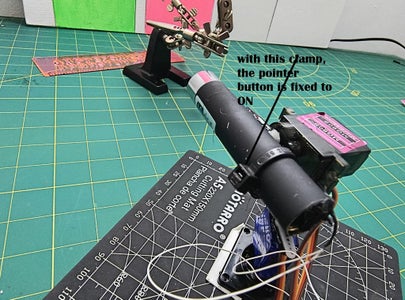

  1. having 3 servomotors in motion, the mechanical construction represents an important factor in the accuracy of displaying the numbers on the paint. Make the solder joints as rigid as possible.
  1. Disassemble the case of the pointer and remove the part that supports the batteries. On the side with the laser diode, solder the wire for the + terminal to the case. and the one for -, in the center, as you can see in the attached image.
  1. fix the laser switch to ON with a clamp.
  1. fasten the 3 servomotors together with the help of a hot glue gun. In the same way, fasten the body of the pointer to the engine wheel 1. Careful! Observe the placement order of the servomotors!
