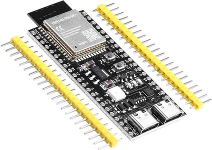

  1. 1 ESP32-S3 N16R8

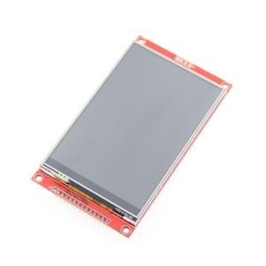

  6. ST7796 4" TFT Display - Recycled from a previous weather-station build

  3. An ESP32-S3 N16R8, driving all animations across two independent SPI buses

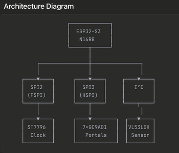

Step 3: Wiring & SPI Architecture (SPI2 / SPI3 / I²C)
The ClockBook uses a multi-bus architecture to drive eight displays and a sensor from a single ESP32-S3.
To keep the system stable and responsive, the wiring was designed around three separate communication channels:
  1. SPI2 → dedicated to the ST7796 (main 4″ display)
  2. SPI3 → shared by all seven GC9A01 round displays
  3. I²C → used only for the VL53L0X ToF distance sensor
This separation is crucial: it avoids bandwidth conflicts, ensures consistent framerates across the portals, and keeps the ST7796 refresh perfectly smooth.
1. Why two SPI buses?
Driving eight displays from a single bus would slow everything down.
The ST7796 alone can consume a large portion of the bandwidth if its updates are heavy.
To keep things efficient:
SPI2 → ST7796 only
  1. No shared traffic
  2. No contention
  3. Fully stable UI
  4. Time, date, temperature, humidity are always crisp
SPI3 → GC9A01 × 7
  1. Shared SCLK, MOSI, DC
  2. One unique CS pin per display
  3. Allows the PortalManager to update each portal independently
  4. Maintains smooth animations even with all seven screens active
This layout gives you the best of both worlds:
stability on the main display, fluidity on the portals.

3. ST7796 Wiring (SPI2 Dedicated Bus)
The ST7796 uses its own bus to guarantee high-speed drawing for the UI:
SPI2_SCLK → ST7796_SCK
SPI2_MOSI → ST7796_MOSI
SPI2_DC → ST7796_DC
SPI2_CS → ST7796_CS
RESET → ST7796_RST
BLK → 3.3V (or PWM if brightness control is desired)
Because the ST7796 works on a clean, isolated bus, it never slows down when the portals are busy.

ST7796 runs on SPI2, fully isolated.
  1. It displays time, date, temperature, humidity and all UI graphics.
  2. It does not depend on the portals and does not react to the VL53L0X.
  3. Seven GC9A01 displays share SPI3 (SCLK, MOSI, DC) with one CS pin each.
  4. All animations are generated by the PortalManager engine.
  5. VL53L0X communicates via I²C and sends a normalized presence value only to PortalManager.
  6. It has no connection to the ST7796 interface.
This architecture guarantees stability, clean separation of responsibilities, and smooth multi-display rendering.

The pins I used in ClockBook (ESP32S3-N16R8)
GC9A01 (SPI3 – bus portails)
  1. VCC → 3,3V
  2. RST → 3,3V
  3. BL → 5V
Pins SPI communs :
  1. SCLK → 10
  2. MOSI → 13
  3. DC → 5
  4. MISO → non utilisé
  5. RST → non utilisé , mis a 3,3V
Pins CS individuels :
Portal 0 → 12
Portal 1 → 11
Portal 2 → 4
Portal 3 → 19
Portal 4 → 20
Portal 5 → 21
Portal 6 → 40 (Sentinelle)
Écran central ST7796 (SPI2 – bus séparé)
  1. VCC → 5V
Pins SPI :
  1. SCLK → 14
  2. MOSI → 15
  3. MISO → 16
  4. DC → 9
Pins panel :
  1. CS → 8
  2. RST → 7
  3. BL (PWM backlight) → 6

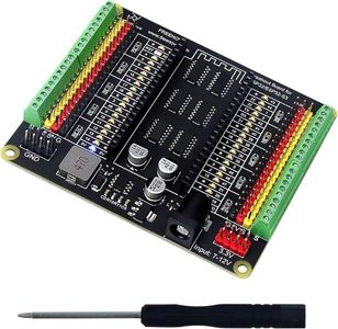

2. ESP32-S3 Bench Setup
The ESP32-S3 N16R8 was first mounted on a breakout board to simplify wiring and to access pins quickly while switching between SPI2, SPI3 and I²C.
This setup allowed me to verify:
  1. SPI2 speed + stability for the ST7796
  2. SPI3 shared bus logic for the seven GC9A01 portals
  3. I²C communication with the VL53L0X
  4. pin mapping and timing

Step 8: The ST7796 Time Interface (UI, Digits, Icons, Weather)
The ST7796 4″ display forms the calm, stable heart of the ClockBook.
While the surrounding portals move, pulse, and react to presence, the central interface is designed to remain clear, readable, and autonomous.
It displays:
  1. time
  2. date
  3. local temperature
  4. local humidity
Every element—including digits, icons, separators, and layout—is hand-coded, with no external fonts or graphics.
The ST7796 runs on SPI2 alone, completely isolated from the portal engine.
1. Fully Custom UI (No Fonts, No Bitmaps)
Every component of the interface is drawn manually using geometric primitives:
  1. custom-built numbers
  2. pixel-precise icons
  3. proportional layout
  4. internal grid for alignment
This gives the ClockBook a unique, cohesive visual identity instead of relying on generic libraries.
The drawing pipeline is optimized to keep the interface crisp and flicker-free at all times, regardless of portal activity.
2. Hand-Coded Digits
Time digits are rendered using a custom function that draws:
  1. vertical bars
  2. horizontal segments
  3. diagonal transitions
  4. rounded corners
  5. controlled thickness
The result is a clean, modern style that stays perfectly readable from a distance.
The digits scale smoothly and perform extremely well thanks to their procedural nature.
3. Time Layout (Hours • Minutes • Temporal Marker)
The UI is intentionally minimal:
  1. large hours and minutes centered on the screen
  2. clean spacing around the borders
  3. no ornamentation
  4. visually balanced composition
This minimalism ensures the central display remains easy to read, even when surrounded by seven animated portals.
4. A Unique Seconds Marker (Time Reference + Memory)
Instead of a traditional seconds counter, the ClockBook uses a glyph-based seconds marker—a rotating hieroglyph that serves both as a temporal reference and as a narrative element.
This marker:
  1. Indicates the current second through its rotation
  2. Carries a trace of the past
As it moves, it leaves behind:
  1. a fading trail representing the previous 3 seconds
  2. a half-lit echo indicating the transition toward the next moment
This creates the impression that the seconds “drag” fragments of the past with them.
It becomes a subtle metaphor for time itself:
every instant pulls a ghost of the previous ones.
It is both functional and poetic—a signature of the ClockBook aesthetic.
5. Custom Weather & Sensor Icons
The UI includes hand-drawn icons for environmental data:
  1. thermometer icon for temperature
  2. drop icon for humidity
Each icon is coded manually using geometric elements:
  1. circles
  2. arcs
  3. rectangles
  4. pixel-level details
All information comes from local sensors only—no internet or API required.
6. Date Display
The date is displayed in a clean, minimal format:
  1. day of the month
  2. month
  3. spacing aligned with the clock grid
It complements the time digits without taking visual focus away from them.
7. Full Independence From the Portal System
The ST7796 interface is completely isolated from the portal engine:
  1. it does not react to the VL53L0X
  2. it does not change color with presence
  3. it does not share animation timing
  4. it does not receive data from PortalManager
This guarantees perfect stability and legibility at all times.
8. Performance
Because the ST7796 is driven on its own SPI bus (SPI2):
  1. there is no flicker
  2. no slowdown from the portals
  3. no bus conflicts
  4. updates remain smooth and clean
This is crucial for keeping the ClockBook practical and usable as a real clock.
Step 9: Boot Sequence & Portal Initialization
Before the ClockBook begins its normal operation, the system performs a structured boot routine.
This routine guarantees that:
  1. each display initializes correctly
  2. the SPI buses are stable
  3. the portals start in sync
  4. the ST7796 is ready before animations begin
  5. no flicker or black refresh appears during startup
The boot sequence is visible through the Serial Monitor and during the first seconds after powering on.
1. Power-Up & Hardware Checks
When the ESP32-S3 starts, it performs the following steps:
  1. initializes the CPU cores
  2. configures the SPI2 and SPI3 buses
  3. configures pin modes (DC, RST, CS0…CS6)
  4. initializes I²C for the VL53L0X
  5. performs internal memory checks
  6. enables PortalManager in an “inactive” state
This ensures the system reaches a stable baseline before touching the displays.
2. ST7796 Initialization (First, Always)
The ST7796 is initialized first, on its dedicated SPI2 bus:
  1. the screen is reset
  2. orientation is configured
  3. color mode is set
  4. brightness/backlight is enabled

Step 10: Code Excerpts (Key Parts of the Firmware)
The ClockBook firmware is built around three major systems:
  1. The ST7796 time interface (separate SPI bus)
  2. The PortalManager engine (seven GC9A01 portals)
  3. The VL53L0X presence system (I²C input → animation modulation)
Below are the most important excerpts from the project code, simplified and commented for clarity.
1. Main Setup — Initializing All Buses & Devices
This snippet shows how the ESP32-S3 configures both SPI buses and prepares the displays:
void setup() {
Serial.begin(115200);
delay(200);
// --- INIT SPI2 (ST7796) ---
gfx.begin(); // ST7796 on its own bus
gfx.setRotation(1);
gfx.fillScreen(BLACK);
// --- INIT SPI3 (Portals) ---
portals.begin(); // Initializes CS pins, SPI3, GC9A01 drivers
// --- INIT VL53L0X ---
if (!distanceSensor.begin()) {
Serial.println("VL53L0X not detected!");
// --- INITIAL DRAW ---
drawClockUI(); // Time + Date + Weather
What this shows:
  1. ST7796 is independent
  2. portals use SPI3
  3. VL53L0X is on I²C
  4. the UI is drawn once before animations begin
2. Portal Initialization (7 GC9A01 Displays)
Each portal is initialized one by one, ensuring clean SPI3 operation:
void PortalManager::begin() {
SPI.begin(SPI3_SCLK, -1, SPI3_MOSI); // Shared bus
for (int i = 0; i < PORTAL_COUNT; i++) {
pinMode(portals[i].cs, OUTPUT);
digitalWrite(portals[i].cs, HIGH);
portals[i].display.init();
portals[i].display.setRotation(portals[i].rotation);
portals[i].display.fillScreen(BLACK);
Serial.printf("Portal %d initialized\n", i);
Key points:
  1. SPI3 only uses SCLK + MOSI + DC
  2. each portal has its own CS pin
  3. initialization is sequential to avoid conflicts

7. Portal Rendering Loop
Every frame, the portals are updated via PortalManager:
void loop() {
updatePresence(); // I²C → normalized
drawClockUI(); // ST7796 (static)
portals.update(); // all 7 GC9A01 animations
Architecture:
  1. ST7796 = stable layer
  2. GC9A01 = dynamic layer
  3. VL53L0X = modulation input
8. Example Portal Animation (Ring Pulsation)
