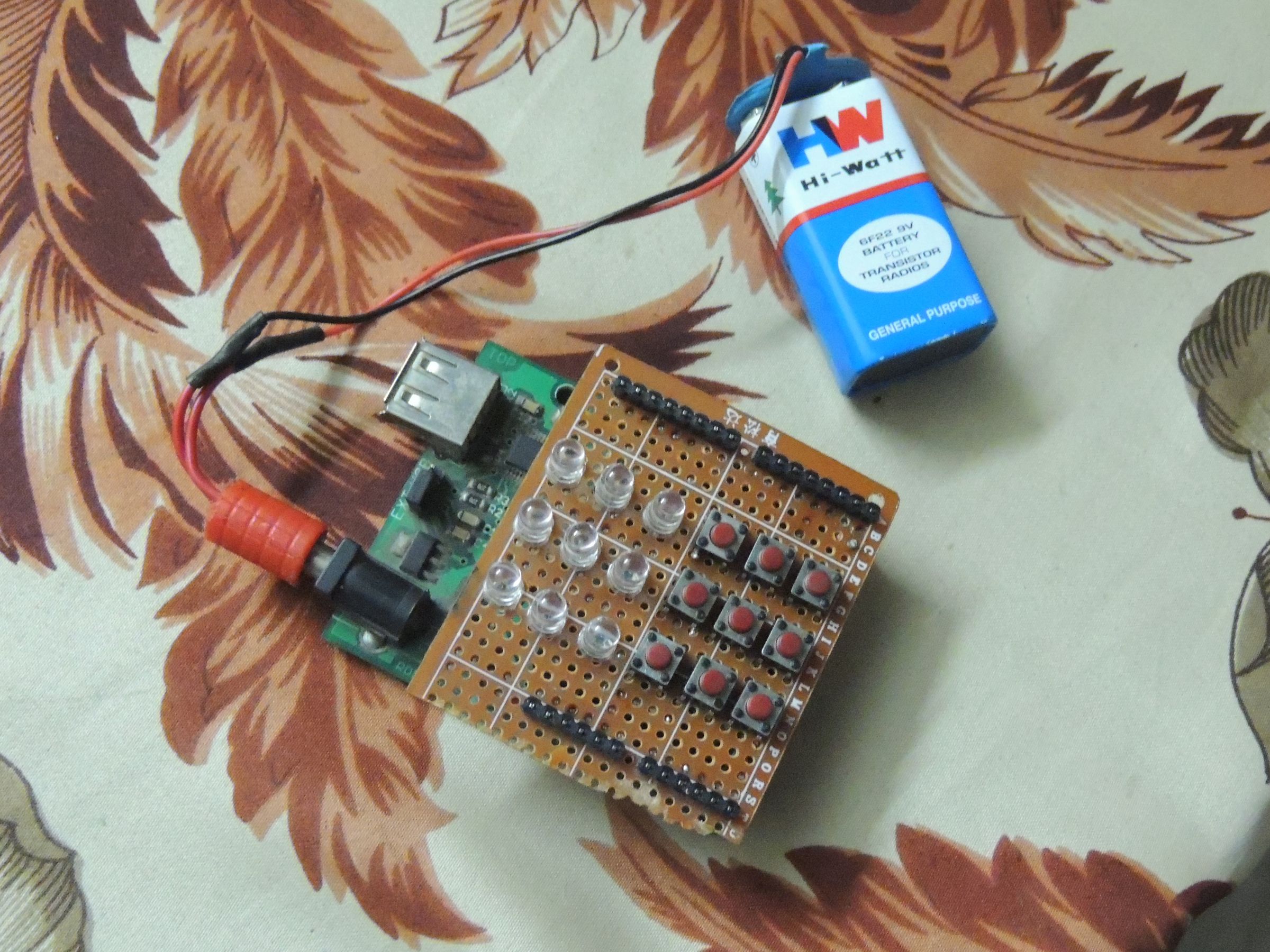

Step 4: Circuit..........continued
Here are some pics of my build....
