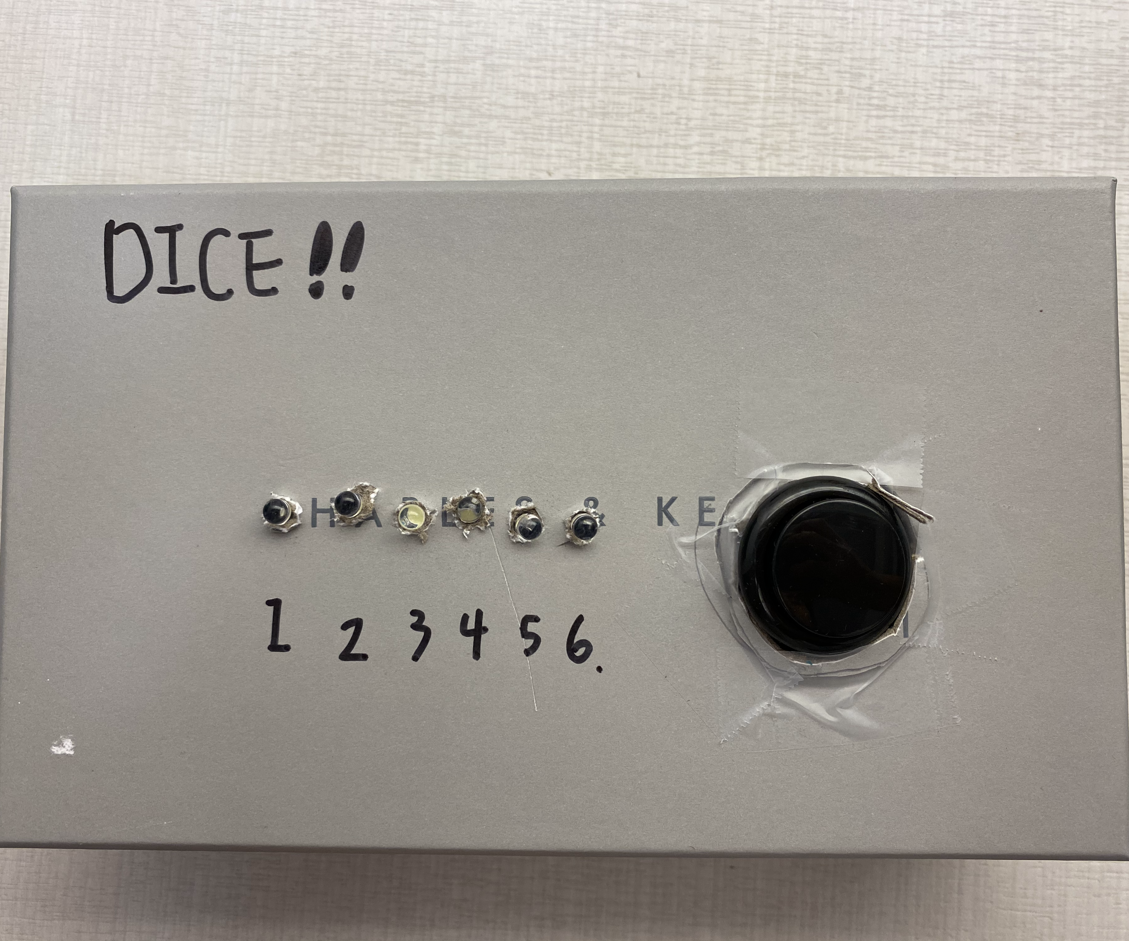

Step 3: Installation
  • The first picture shows the installation of the LED lights and button.
  • However, please be aware that my product changes the push button into a bigger one, there will be a little different. Therefore, the last picture shows how the button will be installed if you use the same button as mine.
Put all the wires, LEDs, push-button, and materials accordingly on the Arduino board. Then connect the LED’s negative terminal to the 220ohm resistors and the positive terminal to the Arduino's digital pins from 2 to 7. Resistors should be connected to the GND pin.
*There may be a slight difference between the models and your own output so the connection may vary. *Make sure to check before connecting to the computer.
*The rest of the connection please follow the circuit diagram above

Step 5: Prepare the Box / Cut the Holes / Stick the Clothes
In order to make the appearance more beautiful, I suggest decorating a box to conceal the wire and circuit.
Find a shoebox that was made of softer material so it is easier to cut. Then prepare a cutter or knife to cut it into a suitable size for the button and the whole Arduino board. When cutting six holes for LEDs, be careful not to cut too much space because the light might fall out. Moreover, when cutting a hole for the button, be aware the size should be precise and exact so the button won’t fall. If the whole was cut accidentally too big, you can use tape to stick the object with the box together.
Lastly, remember to stick six different colors of clothes onto the box.
Optional: Prepare a paper that is at least A3 size to cover the box with your favorite color.
Step 6: Combine It All Together!
Put the Arduino board into the box carefully and connect it to the computer. Thus, you can cut a hole at the side which helps to connect the board with the computer.
Step 7: Done!!
The video above shows how the project works.
Have fun and enjoy it!!!
