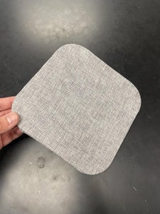

Step 1: Cut Fabric to Size
Lay the grill onto the fabric. Cut the fabric so you will have at least an inch to fold over onto the back side.
