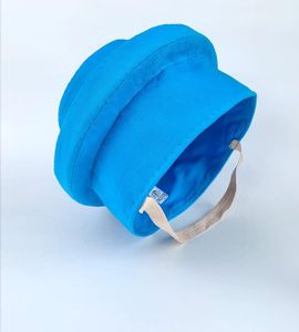

If so, here’s the pattern and tutorial (and instructions for a mini/doll size one too). A LEGO plate, round 1x1, made ~29.765625 times bigger than the actual brick. The finished inner circumference is 23.56”. A colossal thanks to BZPower Members WOLKSite, Xboxtravis and Gifthammer for advice on the actual brick's proportions (via the Discord server)!

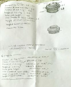

Based off these suggested measurements:
Diameter of top stud- 4.8mm
Diameter of lower cylinder- 6.4mm
Diameter of mid ring- 8.0mm
Height of mid ring- 0.8mm Total height of plate- 4.8mm
Inside diameter of lower plate - 4.8mm

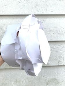

Pattern made by ascertaining a comfy circumference for the head, converting that measurement to mm, dividing that by the lowest cylinder mm circumference, then multiplying the other measurements by that number. Hopefully it’s to scale, unsure if I did it properly. Lived dangerously and only made a paper test subject. The pattern is rough and hand-drawn, my apologies for that. The mini Baby Yoda hat is the same pattern, just print-scaled to 50% with minor alterations (info in steps).
