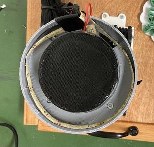

- Take the LED strip lights and cut them to 13" or at a point that is relatively that size where it is instructed for you to cut.
- Solder black wire 5 to the negative connection of the LED and yellow wire 3 to the positive connection of LED strip. To make this easier, use the solder to make small Hershey's-kiss-sized solder droplets on the LED strip at the connection point. Then press the respective wires into the kiss and cover with solder.
- Once attached wrap a small amount of electrical tape around the connection.

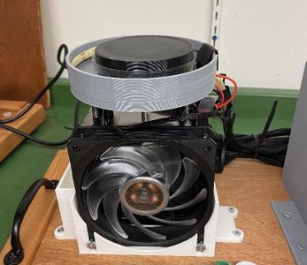

- There is an indentation in the main 3D printed part that's attached to the Hyper 212 cooling fan. Slide the lights into the indentation. To secure the lights add a small amount of super glue to the back of the LED lights then press into the 3D printed part.
- Turn on your cloud chamber to make sure the LEDs turn on
Step 14: Finishing Up

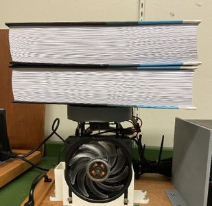

- Put a more generous, but still even layer of thermal paste on top of the 709 peltier and press the black painted part of the petri dish to the top of the peltier
- Place the petri dish with chamois cloth on top of the black petri dish. Use the LED cover to shield your eyes from the LEDs.
- Take the 24-pin wires from the power supply and fold it like in the picture above. Take a zip tie and tie the wire together. Take the 1" wire clamp and screw it in the hole with the #8 x 3/4 closest to the power supply
- There should be one more hole left to screw in. Take the 1/2" wire clamp and place the wires in the clamp and screw it in with the #8 x 3/4 in screw

Step 15: Apply Pressure to Petri Dish Overnight
We have found that we get a more consistent connection between the petri dish and Peltiers if we apply pressure overnight. The petri dishes are just thin plastic, so we designed a "puck" that can be placed in the center of the petri dish and then have a weight (we used a couple of heavy books) placed on it. We then leave this overnight.
Warning! When placing the books on, just be careful not to tip things over or you can decouple the petri dish from the Peltiers.
Step 16: Add Your Source
- Take a pipette and add small dots of alcohol onto the chamois cloth
- We have found that about 0.5mL of alcohol works!
- Make sure that you're using 91% or higher purity of alcohol!
- Place your radioactive source into the petri dish (in the picture is a tungsten welding rod)
- Turn on your cloud chamber!
