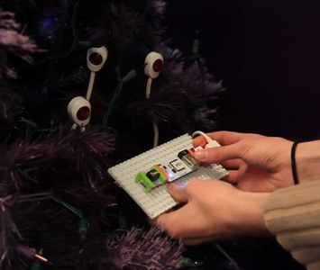

USB power + cloudBit + IR transmitter. We held our circuit together with a littleBits mounting board.Click here for the circuit diagram.
Step 3: AC Switch & IR Transmitter
Now you will need to set up the AC Switch and pair it with the IR transmitter. Check out our Tips & Tricks to learn how to do this.
For our tree, we used 3 AC Switches [on 3 different IR transmitter channels) to control 3 different colored light strings.
