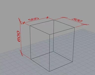

With that, I've designed a metal frame following the dimensions of 500mm X 500mm X 600mm. All the metal frames are joined using screws. With that, now we have a stable frame that can contain the cloud and other components of the device.
